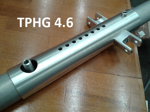

Postby Semper Fidelis » Mon Aug 26, 2024 2:02 pm
Out ot the milling machine one hour ago !
Main Frame of the TPHG 4.6 going to anodisation
I go to bed :wave:
Semper Fidelis
Posts: 115
Postby JoeF » Mon Aug 26, 2024 2:39 pm
Florian,
... pretty parts! Bowsprit?

Furthering options for Joe Cups:
This note regards the possibilities for a Joe Cup using tubular webbing.
Note that the tubular material may be stuffed with flexible shims to gain desired thicknesses to address variations in gaps when two structural tubes are being joined with a Joe Cup. Once the shims are in place, close the two ends of the tubular webbing to capture small rods. Presto, a Joe Cup with the precise gap filling wanted!
Response:
That’s an interesting approach! Using tubular webbing with flexible shims to adjust the thickness and fit of the Joe Cups could indeed help accommodate variations in gaps when joining structural tubes. Here’s a breakdown of how this could work:
1. Tubular Webbing Selection: Choose a tubular webbing material that is strong enough to handle the forces involved but flexible enough to be adjusted with shims.
2. Shim Insertion: Stuff the tubular webbing with flexible shims to achieve the desired thickness. The shims could be made of materials like foam or rubber that can be compressed or adjusted easily.
3. Rod Insertion: Once the shims are in place, insert small rods or stiffeners into the ends of the tubular webbing. These rods will help maintain the shape of the Joe Cup and ensure it stays securely around the structural tubes.
4. Securing the Ends: Close off the ends of the tubular webbing to hold the shims and rods in place. This can be done by sewing, heat sealing, or using adhesive, depending on the material and application.
5. Precision Fit: With the Joe Cup assembled, it should now have the precise gap-filling properties needed to join the structural tubes effectively.
This method allows for customization and fine-tuning, which could be valuable for achieving a snug fit and ensuring the stability of the join. It also provides flexibility in terms of material choice and adjustment, which might be useful for different design variations or specific applications.
