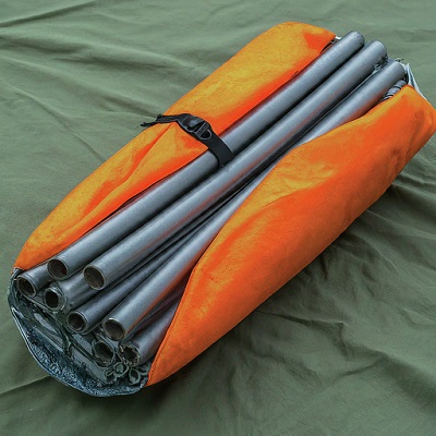

Postby JoeF » Tue Aug 27, 2024 9:25 pm
TPHG Wing One Meter Pack, 1/2 Cubic Foot Pack Volume
I've developed a careful sketch for a TPHG wing design that I'm excited to explore. This wing measures one meter in packed length and aims to achieve a total pack volume of just 1/2 cubic feet, perfect for urban transport. Though small for my needs, it’s a 150 sq. ft, double-surface (DS) socked wing, designed for maximum efficiency in a compact form. The approximate beam pack dimensions are 1/3 ft x1/4 ft x 3+feet, with two socks folding and wrapping around this core, likely fitting into the 1/2 cubic foot volume. This would be quite the achievement!
The design features line-rigged fore and aft meta spars, each consisting of four spar segments for both the left and right wings. The longest packed beam is only one meter, making it incredibly portable. A slight increase in pack volume is anticipated to accommodate the line sets, which can be conveniently stored in a worn waist belt that also holds strap-based Joe Cups.
The wing is supported by a kingpost and two queenposts, with three pitch lines extending from the kingpost to the central-aft SS sail section behind the socks. This setup is intended to provide sufficient strength and stability for very conservative beach gliding, while maintaining the compactness required for a TPHG. If successful, there’s potential to beef up the design for greater strength and stability and safety margins. This build will offer valuable lessons about cambering compression ribs and sock tautening, as well as the challenges of assembly and line-tension adjustment. It will also be interesting to see what, if anything, breaks first!
This design represents a significant step forward in achieving a truly tiny packed hang glider, making it easier than ever to transport to and from flying sites. I'm eager to see how this build unfolds and welcome any thoughts or feedback from fellow hang glider enthusiasts.
Note: Adding weight and getting a bit more wing area might be tried by using wrapped two-piece couplers for joining the spar segments. I aim to try this mod besides the above sketched wing. The 24 pieces making the 12 coupling assemblies along with the tightening wraps will add a bit of mass. This experiment would not have overlapping
of the spar segments at the join scenes.

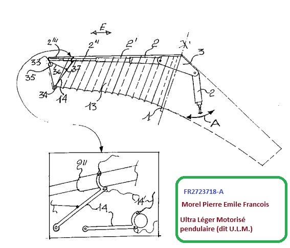

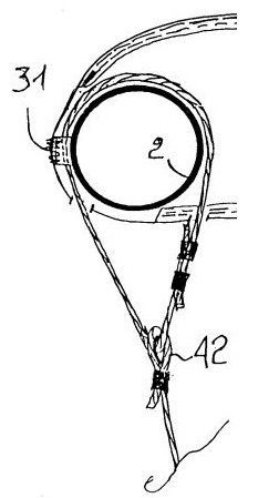

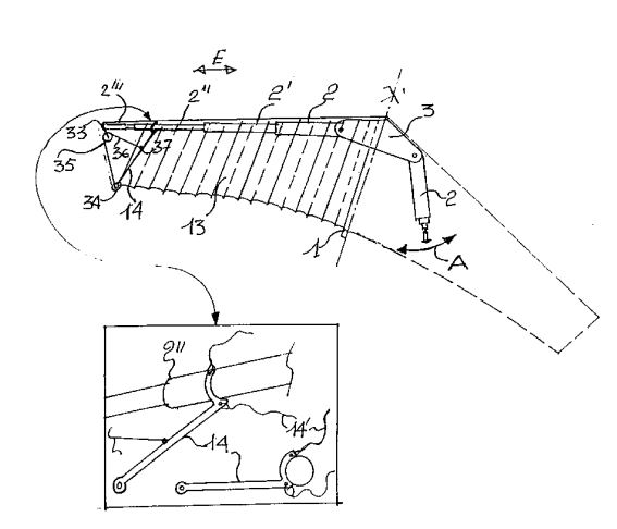

Postby JoeF » Thu Sep 29, 2022 7:33 pm
Furthering some on that former post:
Patent documents: circa 1994
Ultra Léger Motorisé pendulaire (dit U.L.M.)
Ultra-Light Motorized Pendulum (known as U.L.M.)
"La présente invention a pour but, la réalisation d'une voilure pour Ultra Léger Motorisé pendulaire de structure et composants identiques à ceux de voilures classiques de ces engins, mais caractérisée en ce qu'elle est à montage et démontage (déploiement et repliage) automatiques, ainsi que d'encombrement d'empaquetage réduit à celui d'un colis compatible avec les capacités d'un véhicule léger (limousine 5 CV par exemple)."
5 CV (chevaux-vapeur) ...tax bracket.
"The purpose of the present invention is to create a wing for an Ultra-Light Motorized Pendulum with a structure and components identical to those of conventional wings of these devices, but characterized by the fact that it features automatic assembly and disassembly (deployment and folding), as well as reduced packaging size, compatible with the capacity of a light vehicle (such as a 5 CV sedan)."

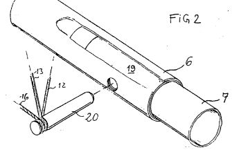

And some investigation may yield fruit:
FR2261178A1 , circa 1972
CHAIZE GABY
Compare the two on rig line anchoring, one loops with pin stop, the other grabs the pin.
Morel rig-line loop stopped by pin.
CHAIZE GABYPinLineHolderDE3637691A1.JPG (20.27 KiB) Viewed 1616 times
