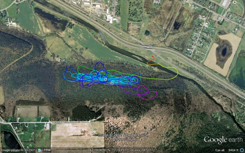

I have uploaded a .jpg screen capture of my flight's track log from Google Earth. The site won't allow actual track log file extensions to be uploaded.
[Note: I have my GPS set to take a reading at 2 second intervals. I would suggest others also set their GPS units to a similar high frequency sample rate. This allows for close examination of flight details. That can help when things go wrong. Imagine if I had set my GPS to record at 1 minute or greater intervals? I'd have much fewer clues as to what happened.]

I have just scrutinized my (ground) speed readings from my GPS track log. What I see (take a look at the picture in my last post above) is that my speed was good up to and including the turn over the river.
However, just after my turn, in the brief straight line course I held, my ground speed increased to 53 mph, and next reading, 47 mph.
If the wind was northerly (picture is oriented with north toward the top) then my speed should not have increased to such a high velocity. If I'd decided to do a radical turn (which I sometimes do with sufficient altitude) it would make sense that I accelerated to such speeds. Thing is, . . . I was at only aprox. 120 feet at this point. I would not have initiated such a radical turn at this low altitude.
It is revealing to me that my speed increased dramatically with this turn. This indicates to me that there is actually a quite good chance that there was a tailing (W by WSW) wind and that that accounts for my speed gain just after that turn. Seems that I (was) turned down wind!
Finally, as my glide went from soaring to slowly descending, I clearly recall the wind flags that I have up on the strip between the river and highway showing a westerly breeze. Therefore, it makes NO SENSE that, at 120 feet of altitude I would make a snappy turn down wind. I will hazard a guess that that low turn was externally induced, not purposefully initiated. I was whacked in mid air by something nasty! This also fits in explaining my final 180 degree stalling turn near the ground. I ended up with no altitude to play with, but attempted to bring the wing back around into the evident westerly wind. That was a better choice than pounding in down wind at 20 - 30 mph!

wingspan33 wrote:I have uploaded a .jpg screen capture of my flight's track log from Google Earth.
It's really amazing to be able to review your flight in that level of detail!! But I'm a little bit ignorant of their color coding. It looks like the color represents altitude. Is that true? Also, is there a way to have the color represent groundspeed?

Yes, the coloring is by altitude, but when converting the file from.gdb to .kml (Google Earth file) I can set the color to show speed. Unfortunately, my old lap top here is too old or slow to handle Google Earth (GE) properly. I've got to transfer the file to another computer in the house and plug it into GE. I'll get a screen capture image from there. Probably have it up tomorrow.
About allowing file extensions, . . . Can you just add a .xxx file extension and be able to down load it? The file extensions for Garmins GPS' are ".gdb". Google Earth is ".klm" . If it's preset and you can't change settings then we may be out of luck.
Below you will see the details of my track log - every reading taken from just before the turn over the river - till I meet the ground. It's only 26 seconds of my flight - but it is the most dramatic part.

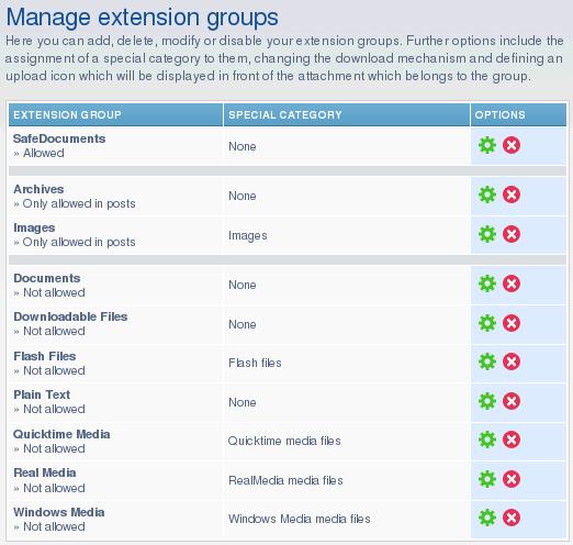

wingspan33 wrote:About allowing file extensions, . . . Can you just add a .xxx file extension and be able to down load it? The file extensions for Garmins GPS' are ".gdb". Google Earth is ".klm" . If it's preset and you can't change settings then we may be out of luck.
Thanks for helping me with this!!
Here's what I have available to me in the "Manage Extension Groups" control panel:
Then there's another control panel that lets me assign specific extensions (like .gdb or .klm) to those "Extension Groups" (categories). So if you see a category in that list that makes sense, I can add those specific extensions to those categories (maybe "Documents" or "Downloadable Files"?). Alternately, I could add a new more generic category for something like "Track Files" or even more generic like "Hawks Allowed Files". Either of those approaches might work right now.
I haven't found a way to enable all attachment extensions (.xxx), but I probably wouldn't want to do that anyway since they warn about specific kinds of files being security risks for the site. So maybe I can try just the ".gdb" and ".klm" in an appropriate Extension Group to get us started. How does that sound?
Thanks, by the way, for helping improve the site. It's good to have you back!! ;) :thumbup:
