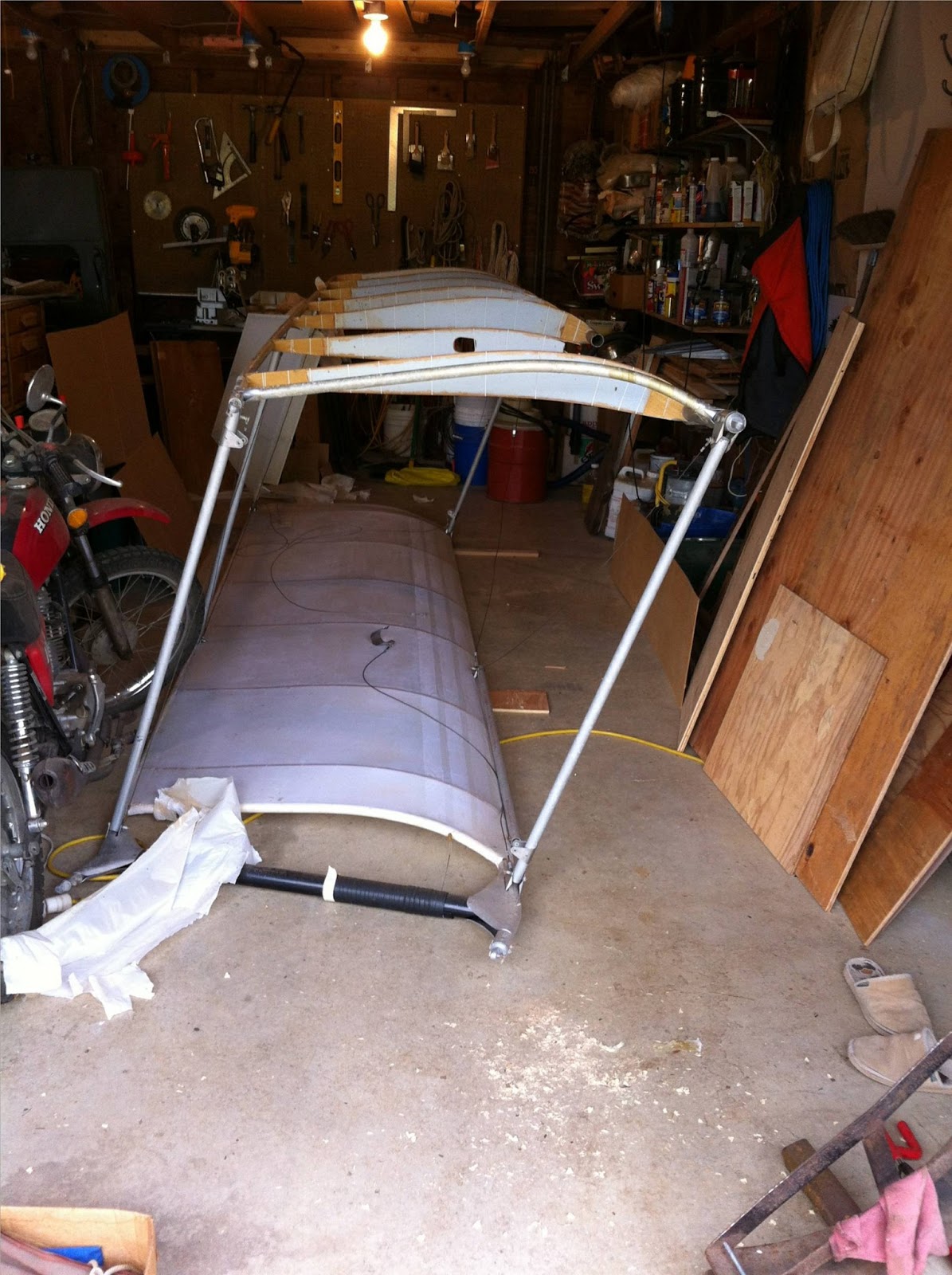

Ordered as a kit from John Moody/Larry Mauro in late 70's as a full motor package. Completed the non-motorized glider portion of the kit using all the original kit materials (Dacron fabric, nitrate dope, 6061 T6 .035 wall aluminum tubing). On the maiden flight, my pilot error put the ship into a whip stall after launch resulting in a dive into a large bush from approximately 60 ft. The frame was bent with the most obvious damage being the upper left wing panel leading edge which broke just outboard of the root, diagonal internal brace. The trailing edge also took a set bend near the root.
My mission is to re-rig and re-cover the entire airframe. My hope is that this blog will be discovered by other potential EasyRiser pilots/builders. I plan to break the posts up into separate parts of the process as I proceed with the repair project.
To begin, here is a photo of the left wing where you can see the upper panel leading edge spar is broken at the second rib out from the root. I have not yet removed the fabric from the lower panel.
OK, cannot figure out how to insert an image from my HD so you'll have to go to the blog or use your imagination.....
Here's a little help from Joe Faust and the moderator:
You can see this kit had the original foam/wood ribs which were soon replaced with stamped aluminum ribs. The hole in the second rib was where the internal brace passed through it which I had removed after the accident. You can also see the front end of the second rib is gone (broke off on impact). On close inspection, I saw no other delamination of the fabric to the rib cap strips anywhere else on the glider frame which I thought was amazing given the impact it took to break the leading edge. The fabric was not rib laced or stitched since I had no plans to ever fly it powered (made that decision after receiving the kit). The next post will include my initial assessment after removing the covering on all four panels.

You also mentioned that you didn't know how to upload a picture, so I took the liberty of inserting it for you (please let me know if you approve or would rather have it removed).
