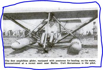

Postby JoeF » Sat May 11, 2013 5:39 pm
Water-landing glider in Popular Science Monthly, September, 1929, page 56.
History leading to such is invited. And details of the shown, also. thanks, anyone.

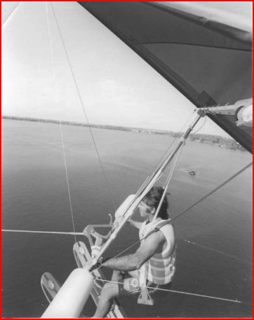

Postby Bill Cummings » Tue May 14, 2013 8:30 pm
Hey Joe,
I started out water tow training in Winter Haven Florida with instructor Rich Johnson January 1978.
I never even noticed the difference flying with floats or without floats.
We never were in any speed contests when flying with floats so the parasitic drag didn’t rear it’s ugly head. I would venture to guess that my buddy Don Ray, wife Terry and I had thousands of flights with floats behind the boat tow operation. We never once thought of floats when needed just to eliminate drag.
However when land towing and planning a XC that would take me over water I would always stuff two Kmart beach air mattresses up inside the gliders double surface. Even without flotation a double surface glider will linger at the surface of the water for about ten minutes. We once thought that we would fill the glider tubes with a closed cell foam but never got around to doing that.
We used the Moyes flotation system that I understand were actually floats that were used for nets to catch fish near Finland. They could have been offered with a lifetime warranty since I still have them today. They are extremely durable. If you didn’t exhaust yourself in the process you could probably kill your boss with one of them.
Possibly that never crossed YOUR mind.
I still like the idea of Helium in the two air mattresses up inside the double surface. Or maybe in a bladder that would take up the whole inside of the double surface.

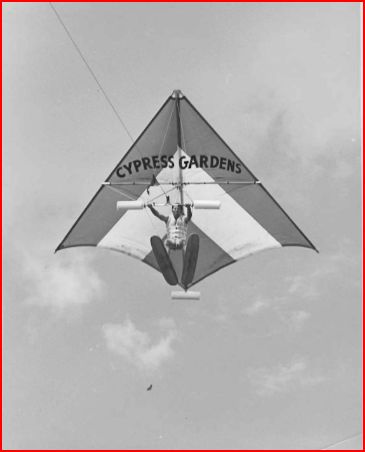

Postby Bill Cummings » Wed May 22, 2013 8:42 pm
[img]
[/img]
Cypress Gardens post card bought at the gardens Jan 78.
[img]
[/img]
Richard Johnson Cypress Gardens Fl
photo. unknown
Richard Johnson.JPG (28.5 KiB) Viewed 15804 times
Richard Kiteman Johnson Cypress Gardens FL
early 70's?
Richard Kiteman Johnson.JPG (24.82 KiB) Viewed 15804 times
