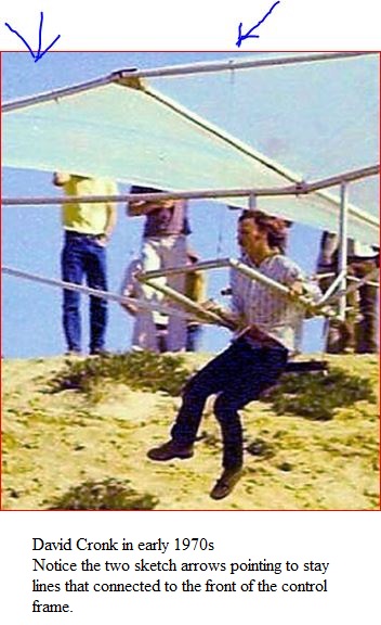

Tease image of Dave:

I think Neil Larson holds the following photo of Dave Cronk:
From unknown source:

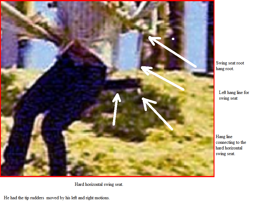

Postby JoeF » Thu Feb 25, 2016 1:12 pm
Some study of the above photo:
CLICK PHOTO TO GET FULL IMAGE.
