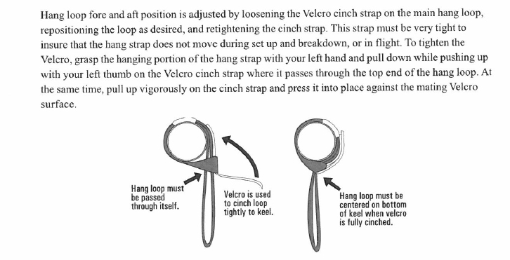

But the snag is that I'm in Australia and have an Australian harness, so I've got the usual issue with the length of the hang loop (about 8 inches too short). I've got a replacement arriving from Wills Wing in a few days, so no drama there. But I do have a few questions about this.
This is the first WW glider I've owned (all my others have been Aussie brands). On all my other gliders, there's been some sort sort of retaining mechanism that fixed the hang loop in place, but on the Falcon, the hang loop is only secured by friction, i.e. being cinched tight enough to avoid shifting in flight (as described in the manual - see attached image). This strikes me as being just a little dippy.
Am I being a bit paranoid about this? How do you know if the hang loop is tight enough short of flying and finding out the hard way? The manual says "very tight", but how tight is very tight?
I don't think so. The worst place to ever find your cg/hang point has changed is in violent air. I used to tape down my hang straps with strong reinforced fiberglass tape with several wraps around the keel.

I don't think this is a bad hang loop securing design. But that doesn't mean you can't customize it to suit your interests.
But before going that far, if you KNOW you need to change the position of the hang loop, . . . then follow the directions (with common sense) that WW includes in the manual. Then, what I would do is, hook into the hang loop with my harness (glider set up in the back yard) and YANK the heck out of the re-installed hang loop. Does it move? If so, then you haven't got it tight enough! lol
Wills Wing's designers/engineers have determined that the their "cinching" system works - or they wouldn't let the system ship out.
Now, all that being said, Rick Master's comments about wrapping the strap with reinforced tape is one way to modify the hang loop - to your personal preference. I would look into some method of sewing the straps together in the tight setting (using heavy Dacron/polyester thread). Or, a little "Super Glue" could also adhere the straps once they are tightened (not sure of how good this suggestion is - proceed on your own risk here).
In the end, personally, I would go with the idea at the top of this post. Change things (one way or the other) if you are not satisfied. Last resort, . . . Call Wills Wing! :)

1. When the hang loop is clinched on a friction base, movement is unlikely.
2. It is when a hang loop is under no active load that one might consider how untightening might occur and inadvertent movement of the hold position might occur. When the hang loop has been in storage, just how much relaxation of "tight" occurs? Then inadvertent push or pull during handling, unpacking, opening, etc. might move a relaxed clinch and not be noticed. Having a positive secondary position-keeping tie would address such matter.
3. I put up a red flag on the stitch-at-tight or the glue-at-tight idea; Creep during tensed "tight" may occur and one might end up with a stitched relaxed hold or a glued-relaxed hold. Such stitch or glue might prevent flight loads from keeping the hold tight. Secondarily, be very sure that stitching or glue does not bring on a long-term injury to the fibers of the hang loop. Consider the matter very carefully before going to a stitch or glue situation. My vote is a no on such.

Just to clarify, I wasn't seriously questioning WW's design by any stretch. ;) I have great admiration for their professionalism and experience (which is why I've just bought a Falcon after a couple of decades of buying Aussie gliders). I imagine that it's so designed that adding weight will tend to cinch it even tighter on the keel. As I mentioned earlier, it's mostly a paranoia thing, but also just to have everything 'squeaky clean' so to speak. And also to mitigate against me stuffing up somehow when replacing the loop (much more likely than WW buggering up).
But I'll certainly be taking your advice and do the ground-based stress test and make sure that nothing shifts. And obviously, first flights on the training hill.
