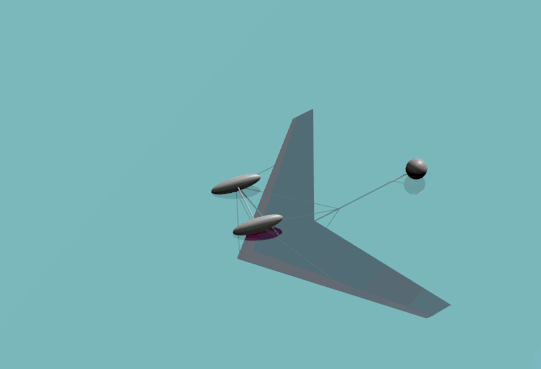

Postby Bob Kuczewski » Fri May 29, 2015 11:49 am
Bill, the detail of your post assures me that you've done this many many times before.    ;)
That reminds me of your detailed description of how to flip a submerged glider leading to this animation:
I'd like to see us using Blender (and other tools) to do more animations of our ideas in the future.    :thumbup:
