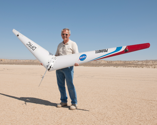

This is an interesting new wing development. The fact the they tested it on a model glider and are now going to another model glider almost hang glider size would indicate that its low speed performance is good. :thumbup:
Check it out: http://www.techbriefs.com/component/con ... qotw/23443
Also notice that the article mentions the possibility of a roll-up wing version going to mars. That would be interesting for the "5 foot packed" thread on this forum. However, I have no idea how that would be done.

We HGer's prefer the flying wing design because it provides a means to fly with the minimum parts count. Parts= weight.
Of course I'm referring to the big parts here. The FW has only what we need: two wings and a 'handle'-the control bar.
It seems to me that the FW found it's home in HG. But it also has found a home in the military, where it's stealthiness is an advantage.
Other uses include 'drones' of various purposes, and I include the Mars glider here.
My own personal feeling is that the lack of vertical surfaces is a mixed bag. The speed and ease of rigging the small tail fin on my Sensor indicates that maybe the finless swept-aft planform might get some competition from HG designs having little or no sweep, and a simple fin instead of sweep.
Swept wings present us with torsional rigidity issues. It's easy to understand why we have stuck with them, as they simply evolved from the Delta design we started with.
The problem, as I see it, is the marriage of pitch stability and washout. When I fly a modern high-performance HG, I'm impressed with how much of our parts count and weight budget is devoted to this area. Two washout struts per side, and a spar that is robust enough to handle the loads imposed by them. And the not-so-funny thing is, on many flights we never even use them.
I suppose I should have posted this on the "Different way" forum, but here I am.
We might be able to reduce parts count and therefore weight by divorcing washout from pitch. I'm impressed with how effective the small tail fin is, and I don't need a whole lot of creative visualization to see that a larger one could be rigged and de-rigged almost as easily as the small one. And it just might be lighter than the current beefy leading edge with struts that we now use.
We all love the graceful, simple beauty of the aft-swept and finless Horten design. But I wonder if we couldn't do better with some re-thinking of our goals.
