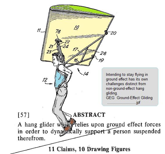

This patent is literally proposes cardboard as the major component for the ground skimming wing.

As long as it is kept dry and the load calculations are correct no reason why it would not work. I have built a number of models using cardboard packaging. A V Roe (AVRO) used oiled paper to cover his early aircraft.
For ground effect the closer the wing is to the ground the better. The problem is the wing becomes more vulnerable to damage the closer to the ground it gets.

The height to which ground effect extends is proportional to wingspan & aspect ratio. The pilot hanging below the glider requires more height distance for ground effect thus requiring more wingspan. I think one would be at the point where the glider would have enough wing size to be used in normal hang gliding as well.

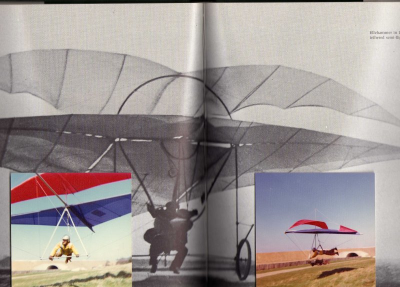

Taras Kiceniuk, Jr. and his ground-effect vehicle

Postby ARP » Sun Dec 20, 2015 4:19 pm
Ground skimming:-

Postby Frank Colver » Sun Dec 20, 2015 5:24 pm
Notice that Taras is sitting above his ground skimming machine thus greatly lowering the required height to still be in ground effect, unlike the cardboard device shown previously.
One thing I have done with a large R/C glider was fly down a very shallow slope that closely matched the glide angle in ground effect.
It's also good to watch sea birds using ground effect to skirt the waves as they roll in toward the beach. In this case they also use the air being displaced (for lift) by the wave as it moves. But even without a wave it is very obvious when the birds enter ground effect as their glide angle flattens out tremendously.
