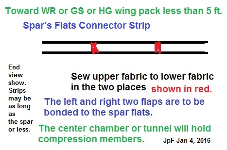

Connector for the long spar flats. Connector has chamber for compression elements.
It is key that the upper surface and lower surface be sewn, as the compression elements during inflation of the spar bladder will tend to spread the connector's upper surface away from the connector's lower surface. The sewing will prevent the disruption of the bond of the connect with the spar flats.
The left and right flaps of the connecter will saddle the spar flats and be bonded to the spar flats.

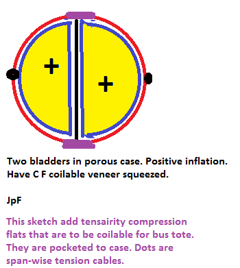

Recalling a version that adds a carbon-fiber coilable veneer whilst using two separate bladders to squeeze the veneer.
My recent posts above in this topic have had a focus on casings that may add a "shelling" role to a significant degree besides the tensairity splinting deal. Perhaps mining all three methods: shelling, tensarity/(splinting compression members), and squeezed CF interior web. Targets: short pack and effect strong-enough spar (per niche HG activity).

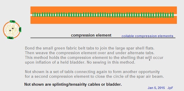

Here is today's which does not use sewing. The following has a potential of being lower mass that some of the other above noted connectors.
The following also permits highly dedicated direction for the connector parts; hence I used the word belting to give the focus on having the little fabric hinge connectors be with dominant fibers in the belting direction. Though the drawing looks like a zipper, it is not a zipper. The orang flats are wing-span long. The green tabs are fabric bonded permanently to the orange spar flats.

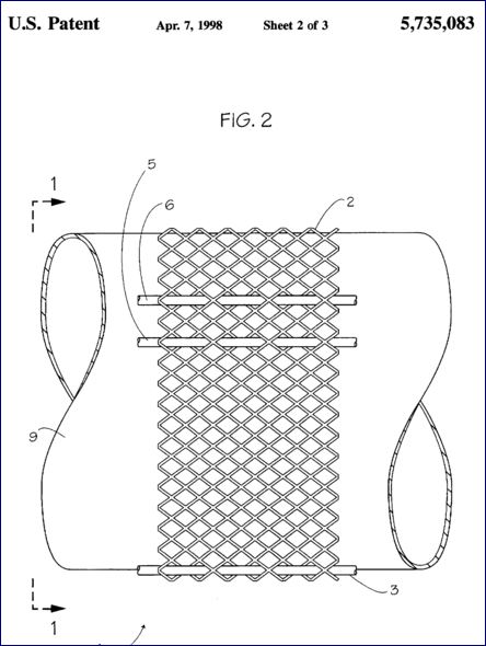

The following patent instruction is important in itself for some types of airbeams; but notice that the instruction is not about using axial compression elements coupled with splinting cables or webbing; however the "axial fiber bundles" begin to approximate axial compression members for resisting bending and buckling of the airbeams. The following patent's instruction is in the family of airbeam options. But what Glen and his partner instructs is fertile ground for some anticipated HG-spar options. I anticipate combining Glen's instruction with other airbeam technology (interior walls, tensairity compression elements stayed with cables or webbing, and shelling flats).
One of the patentees, at least, Glen J. Brown has a hang glider background; and he also worked closely in industrial airbeam matters with the hang glider pioneer Roy Haggard of UP Comet design fame in mid 1970s.
Some background on Glen: http://www.zzipper.com/about.php
https://www.google.com/patents/US5735083
Some terms in the patent:
spar braid
tri-axial braid
stripes
braided fiber structure
pre-wrinkle stiffness against bending
Some clips:
"A braid with three or more axial fiber bundles will resist bending about all axes."
"higher wrinkle onset moment and damage-free buckling with light-weight construction."
