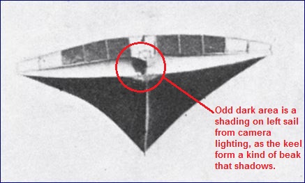

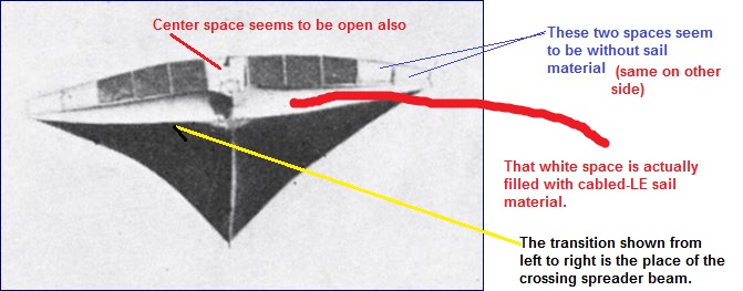

I think it is the same machine in both photos. Note the outer panels of the top wing are not filled in on both.

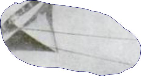

The leading edge of the main wing is formed by a wire in front of the cross spar. The material colour looks different, caused by the light and shade. What looks like sky in between the top and bottom wing, in the first photo, is the front of the wing from cross spar to wire leading edge. It is easier to see this on the second photo.

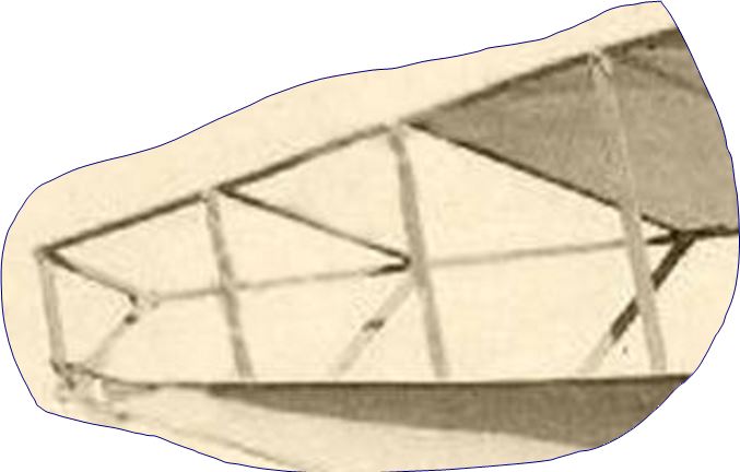

The top wing uses a series of triangulated struts supported from the cross spar.
If the designer did use the Platz glider as his guide he did not do a very good job and made it more complex than it needed to be. The aerofoil is compromised in the same way that the flat kites are with the sail pressing upwards on to the cross spar.
Tony
Excellent! So, the distant views might fool someone into not noticing the sail that is LE cabled for the main wing below the rigidly held upper wing set which I would call a form of a "high hat". Thanks for pointing that the upper high hat (my term) does not have sail coverage in the outside two spaces in the frame.
[[Cable-LE high-hated anachronistic-Rogallo kite with triangle frame undercarriage ready to receive control by ski kiters and hang gliders ??? :angel: ]]
On the second deck there are diagonal bracing wires holding the high hat form moving in any collapsed parallelogramatic fashion.
The original large photo with Ruth waving seems to show a tow line connected to the keel about ... say 6 in in front of the spreader beam.
The Popular Science article rehearsed a bridling that seems to have two tethers in PS photo. I am wondering if he ever towed using single-point tow. The undercarriage is not seen by me in the two different photos of the wing in flight.

The wire braced triangulated framework between the two wings provides the rigidity and strength to support the craft and payload in flight.
The lower wing is fashioned like a high aspect ratio diamond kite. The 'flat' water ski-kites used a low aspect diamond configuration with a truncated tail. Both designs restricted the sail from forming a proper aerofoil shape as the cross spar is above the sail.
The in flight pictures are not clear enough to determine if the undercarriage is attached. Being a flimsy structure it may simply be too small to see at the distance the picture was taken from.

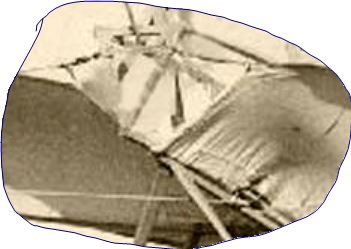

The undercarriage consists of six beams and the basebar; then four wheels.
On the flight photos: I see no light interruptions for the six beams or wheels or basebar. At the same photos, details of lines and similarly sized parts do show. So, I am holding out that the flight photos are not showing any undercarriage for the reason there might not be undercarriage in those photos; this wrestles with ARP's suggestion that an undercarriage just might not show up.
With "200" flights, I am holding out for adjustments, variations, .... I wonder if family Argabrite has more photographs or notes on the flight adventure.

Looking at the undercarriage more closely it could be a detachable unit. There appears to be struts on the undercarriage that line up with the keel and wing spar of the kite. ("The undercarriage consists of six beams and the basebar; then four wheels." this would make eight beams. ) If so, it would be a relatively simple job to un-lash the bindings to fly without undercarriage. It might be the undercarriage was only used when the kite was loaded with pilot or ballast? The undercarriage would be providing additional structural strength at the kite keel and wing spar junction.

Some counting: not my 6 and I contest 8, but now go for 9 beams:
It does seem that the entire undercarriage, as ARP suggests, could be with an integrity that would be attachable and detachable.
