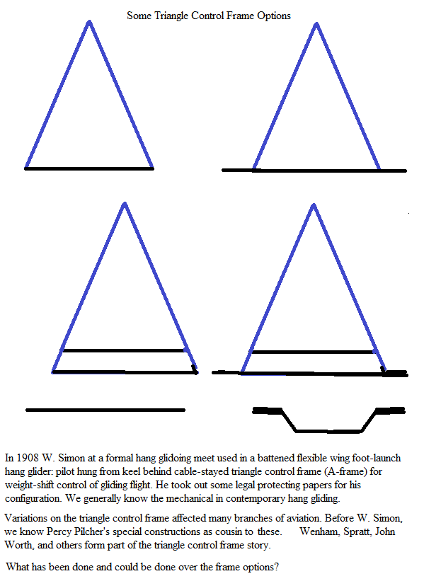

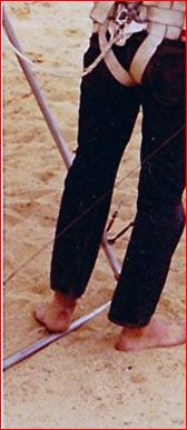

Dick Eipper barefooted at Dockweiler in 1972 is shown with a TCF where the root of the flying wires is up on the legs away from the base beam of the TCT. Recall that the base beam or basebar or base bar is in tension during normal flight loads; some people have installed a redundant cable inside the bar connected to the flight-wire assemble; such would be hidden from view. The connection point shown would tend to pull the leg out of column; perhaps an interior sleeve could bolster the arrangement. The position of the connection puts the flying lines up away from grass and shrubs somewhat. Some mid-60's ski kites had the connection of flying lines up away from the basebar on the leg approximately as shown.
Before the ski-kites, John Worth connected flying lines sometimes to a base up a substantial distance; on some of his hang gliders he would use two TCF between which would be a platform for holding payload; other versions the payload would be mechanically the base to which he would connected flying lines where the base would complete the triangle, even if payload object was elongated from fore to aft. W. Simon in 1908 had the flying wires go to the junction of the leg with base bar on his A-frame or TCF. Some strut-braced TCF have the struts going to the junction of the legs with base bar.

Later in September of 1963, a tinkerer on a ski-kite would also use the TCF cable-stayed TCF (as we know such was used in 1908 on a foot-launched hang glider by W. Simon at a sport hang gliding meet).=

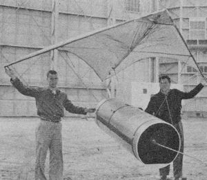

John Worth, one of many configurations of flying lines going to a base to form a triange; here the payload formed the base:
On a different John Worth project he had the side flying lines connected to a point above the base:
Shown project used a second TCF to ease the handling of the payload.

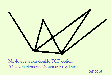

Seven Strut Control Frame
No lower wires
Lower interior space of the seven elements might be filled with stored electricity.
The seven elements may be streamlined.

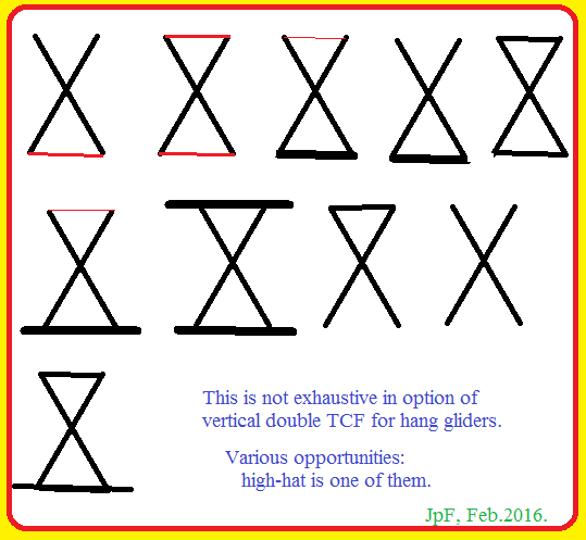

Vertical Double TCF options
http://www.fliegerweb.com/inhalte/Geschichte/Flugzeuge/GradeEindecker/KunstflugmaschineGrade_.jpg
Operated at Dockweiler in 1962
As published in FLIGHT International on publication date of August 1, 1963.
Thus craft occurred before that publication date.

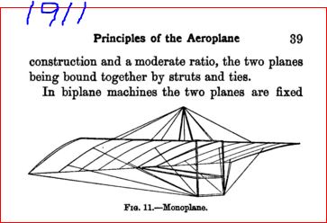

A book:
Principles of the Aeroplane, 1911
Click above line for the full book.
