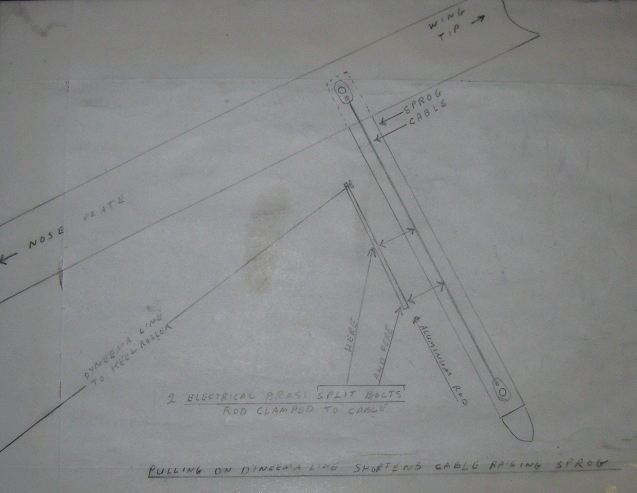

Postby Bill Cummings » Sun Apr 17, 2016 10:15 pm
Below in quote "height shift" is a typo. It was supposed to be weight shift.

Postby billcummings » Thu Apr 14, 2016 3:04 pm
On my other laptop I have a drawing of an idea that I came up with that would attach to a sprog cable that would twist the cable shortening it to raise the sprog. This would be accomplished with height shift to raise the sprog thus raising the trailing edge to help with a turn. To offset any yaw a vertical stabilizer would also be used.
The sprog cable would have an Aluminum 3/16" Diam. by 18" long round stock rod attached along side of the sprog cable by means of two copper electrical split bolts.
One split bolt would attach to the sprog cable at midway on the rod. The other split bolt would attach the end of the rod to the sprog cable.
At the free end of the rod a control cord would be fastened.
Pulling on the cord would make the center rod split bolt pull while the other split bolt at the end of the rod would push toward the wing tip.
The force would move the sprog cable out of a straight position and raise the sprog tube.
The raised sprog tube would raise the transverse batten raising the two battens above the transverse batten.
This would cause the wing tip to drop which is what the weight shifted pilot was also doing. Trying to drop that wingtip.
Sprog control surface.PNG (742.52 KiB) Viewed 13420 times
