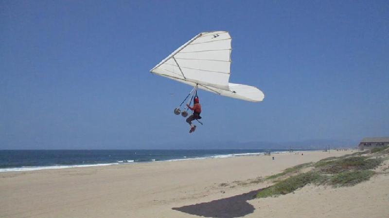

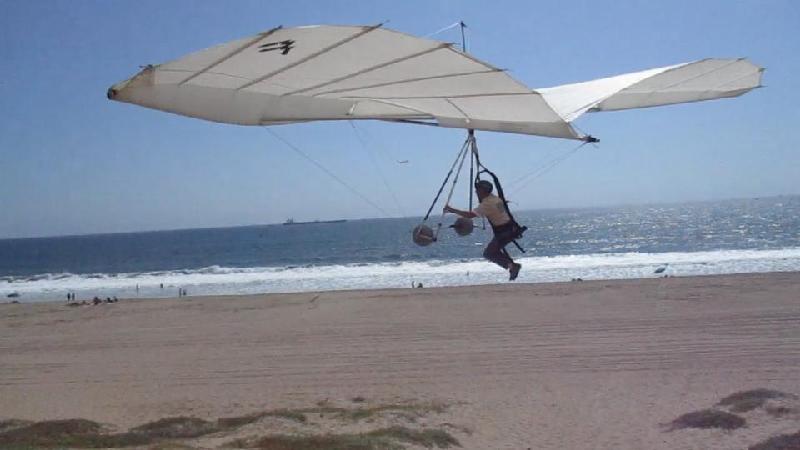

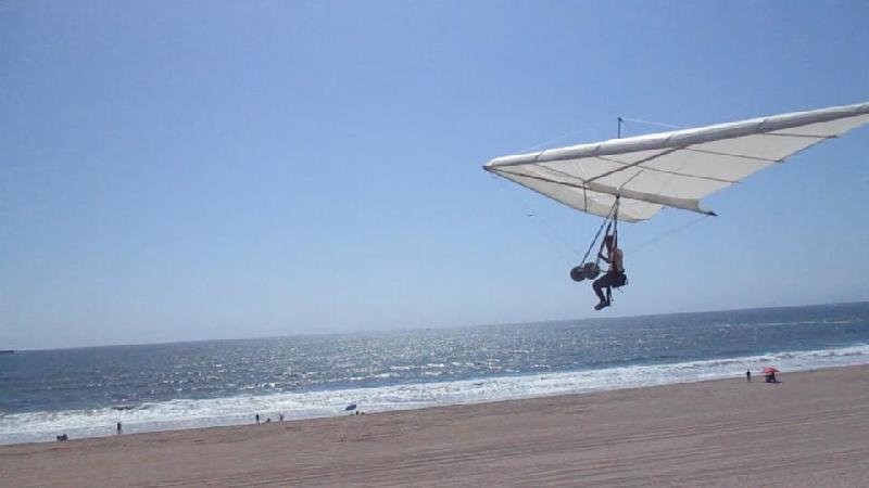

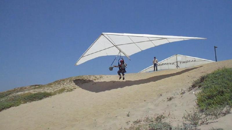

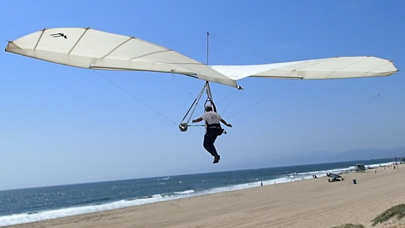

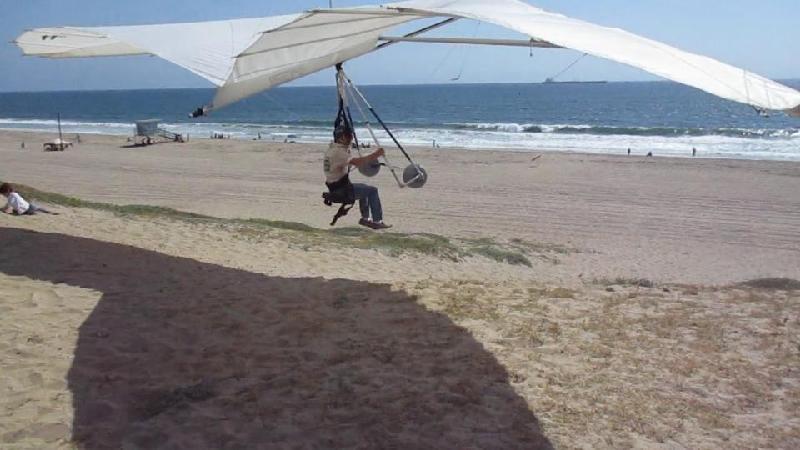

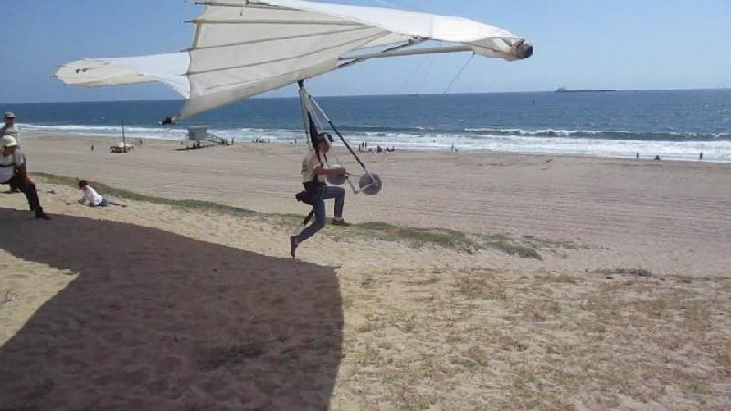

I didn't get pictures of everyone who flew the Colver Swing Seat at the 2018 Otto meet, but here are a few frames that I found among my videos.
Andy Beem:
Joe Greblo:
John Heiney with assist from Joe Faust (Frank in the background):

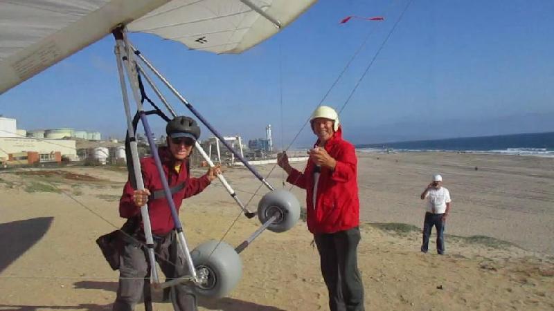

Postby Frank Colver » Sun Jun 03, 2018 2:10 pm
And here is a young woman named Erica giving it a try. She and some of the others soared the bluff in the swing seat & holding the uprights of the adapter bars.
I remember form my old days of "dune grooming" that the upright position makes it easy to watch a wingtip that is close to the sand.
For me it was like being home again, as soon as I was in the air. I always loved seated position hang gliding. :thumbup:

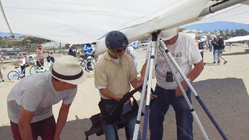

That's how this thing got started. I was spending time at High Energy Sports with Jim Fenison as he developed his suprone harness along with their expertise. I knew that Betty was going to drop by to say hi so I pulled my Eipper/ Sears swing seat off of the old Flexi Floater control bar and brought in there as a nostalgia thing. I hoisted myself up on their winch hook to demonstrate how it worked as one transitioned from running to sitting. As I was swinging about I commented that I loved to fly in these things. That's when I thought: "hey why not make a 21st century version of the swing seat from the seventies".
Along with their guy who works miracles with a sewing machine, Jacob, we hashed out the design and the result was what you see in the photos. As usually happens with any new design, a couple of problems were found at Dockweiler that day. Today I was back at HES and Jacob did another fantastic job of correcting those. In my opinion now, this seated harness design is good to go.

Postby Frank Colver » Fri Jun 08, 2018 9:36 pm

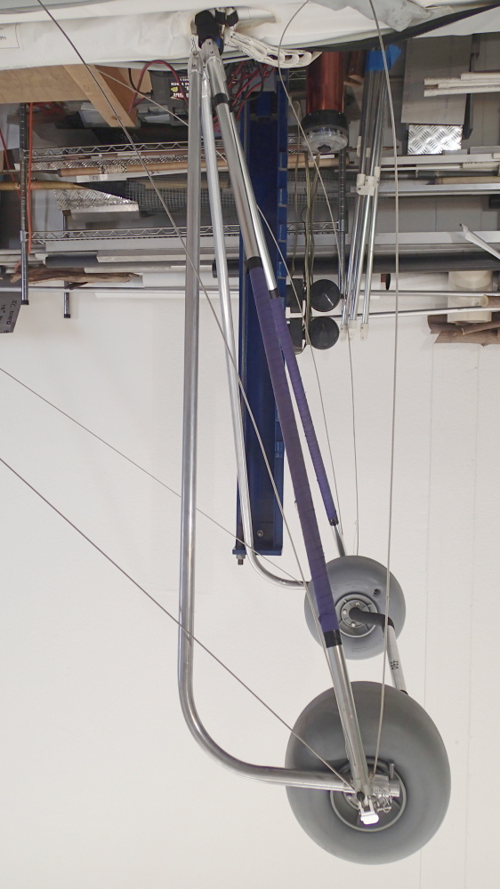

Here's the finished adapter bars mounted on the control bar.
I also narrowed the seat insert width to bring the hang straps in farther on the shoulders and snug things up a bit. That also takes some more weight out of the harness.

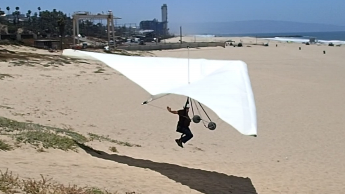

Postby Frank Colver » Wed Jun 13, 2018 9:29 pm

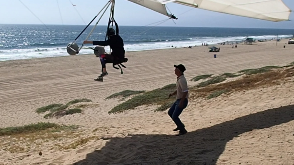

Here's me waving to Bob and Joe on my first flight with the modified seat harness.
Flying in this position makes you want do do something and not just sit there. :wave:
