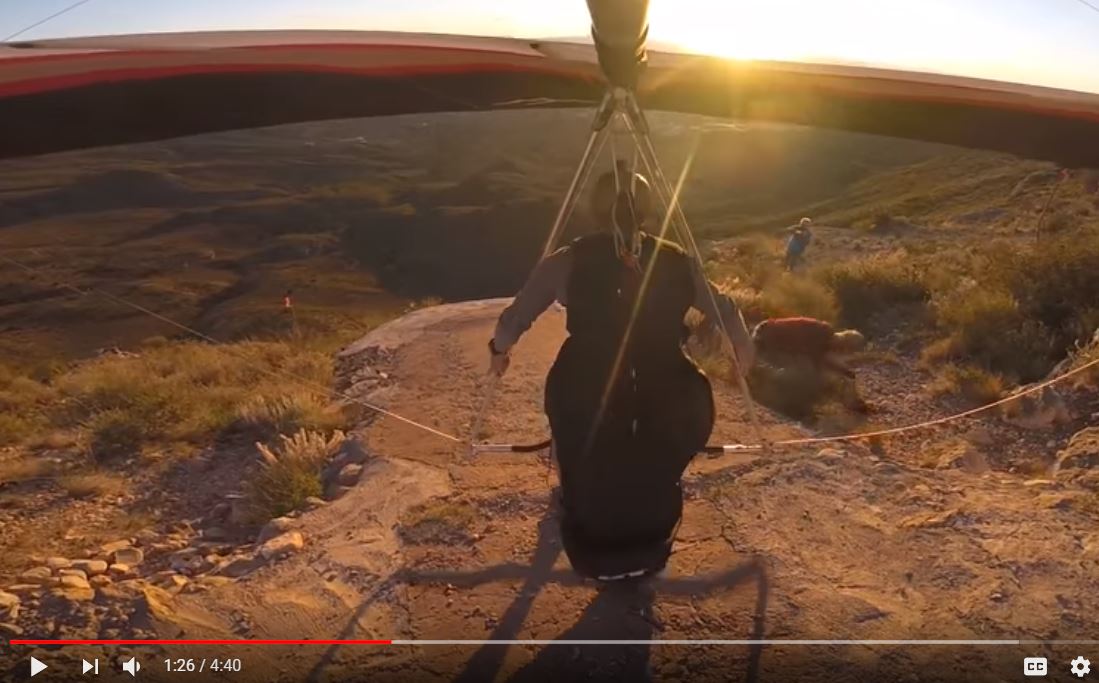

Mtich G shares his:
My worst crash ever...Hangliding
Video.
Also, this is being studied elsewhere.
Mitch G
Published on Oct 19, 2018
This is still hard for me to watch. This happened on the 5th of OCT. It was a combination of a lack of proficiency, wind changed directions as I took the first step forward (glider yaws), strong conditions, wing tip caught a bush, and not far enough forward on the launch ramp (clean air to both wing tips)
I can only be thankful that I was not seriously injured. You can see the few seconds after impact I didn't move...but I dont remember doing that. My neck and back were very sore for about a week but I feel almost fully recovered after 2 weeks.
I dont know If I will fly hangliders again. I dont fly them enough to stay current and fly at difficult launch sites with strong conditions. I have not repaired the glider. If you have interest in buying it feel free to send me a message.

The "tight left / slack right" wires were a bad place to start. It might have been better to move further down the ramp. I also noticed the instant reaching for the base tube and trying to kick into the harness right away. I see a lot of pilots doing both, but the first job should always be flying the glider safely away from the hill. But I'm not sure if anything could have overcome launching with that much differential lift. It's very fortunate that he wasn't badly hurt or killed.

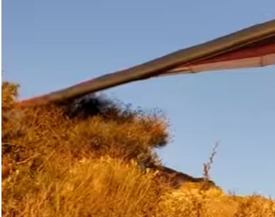

The matter worsened with the right wing tip catching the shrub.

One of the dumbest launches I've ever seen.
I would never launch like that. Never!
You never even flew the glider on your shoulders!
You were in a turn the moment you decided to run.
Of course you crashed.
You even had a wireman and didn't use him.
You never gave the right wing a chance to take the air.
You had no respect for the glider.
You had all the time in the world to do it right.
You could have stepped ahead of the bushes so your wingtips could have clean air.
You didn't.
You could have stood there and flown the glider for a while,
Getting a feel for the wind direction and pitch.
You didn't.
Never once did you find the direction of the wind.
The poor hang glider never had a chance!
I feel sorry for that nice glider being in your impatient hands.
What is your big hurry?
Did you have to catch a bus or something?
You made that glider crash.
Wishful thinking has no place in flying hang gliders.
The glider has to be flying before you run.
You have to allow it to dance in the wind coming up the slope.
It's joyous. Don't be afraid of it. Embrace it.
You have to let the wing find its point of balance.
You know you have it when you can turn the nose a little bit and one wing wire goes tight,
then turn it the other way and the opposite wire goes tight.
You could have learned a lot if you had walked out to clean air with your wireman holding the nose.
You could have stood there for ten minutes, flying the glider on the ground.
It looked like a really nice day to me.
Definitely a one-step takeoff.
There is no excuse for this accident.
You own it. You made it happen.
I don't care of there are 50 guys behind you.
You never launch until you're comfortable and the glider is dancing and eager and flying straight and level in your hands.
You had good air a few steps in front of you and you didn't feed it to your glider.
You starved it and then you broke it.
What were you thinking?
On gusty Gunter launch in 1981, I asked my friend Klaus Kohmstedt, "Are you worried?"
"To take off? No," he replied. "I control everything up here. I can choose the moment when everything is right. It is the landing I worry about."
Until you become one with your glider, stay away from the great sites.
They are great for a reason.
They are where men become eagles.
Not where turkeys become eagles.

FYI, Tad did a good frame by frame analysis of this launch on his site:
http://www.kitestrings.org/viewtopic.ph ... 170#p11143
From the earliest moments of the launch, the pilot was fighting to keep the left wing down. That's a loaded spring ready to release. He should have backed off right there and started again.
