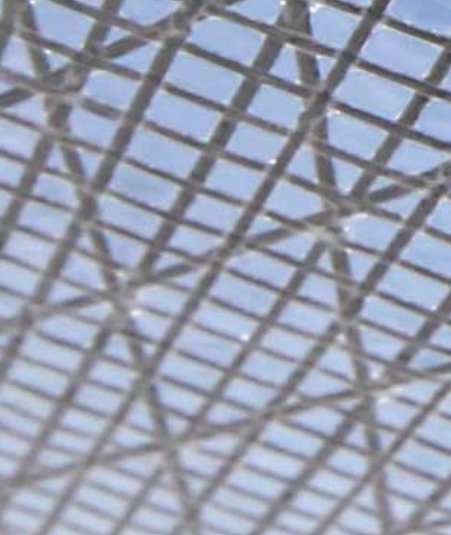

Trash Technology for some Hang Glider Sails
With quality net of good-sized mesh consider upcycling trash to cover the net's open spaces. Super rip-stop. Lose some little patches and just repair that little patch. Say a Dyneema-string net forms the quality base of the sail. Then cover each open space with films obtained from trash. Such tactic might bring on very low mass sails to reduce tote mass and flying mass. Domina Jalbert was an early advocate of making kite sail material by having a net of lines while filling the interstices with low-mass material. Now there is a huge use of ripstop nylon and ripstop polyester fabrics. But the hybrid of fiber net with film fillings is a flow used in top commercial hang glider manufacturing as they use laminates that are just that: fiber nets laminated to film to fill open spaces of a matrix of lines. For a certain combination of net and film, there may be optimal choices for te net for a specific hang glider. When going for low mass and tiny pack, then the choices would be modified.
Edging for such nets may receive special design cares; sometimes edges of the filled net would be at a spar.
