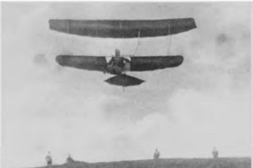

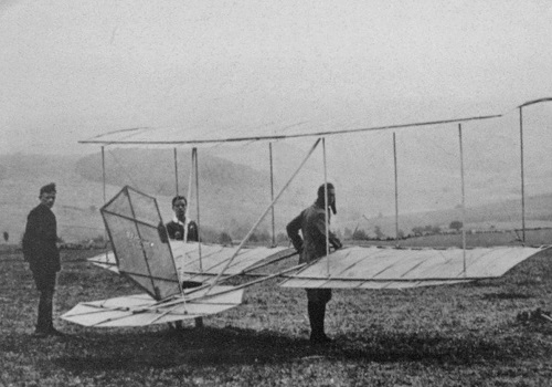

Maybe his first, not sure: ... a doppeldecker ... Doppeldecker Hangegleiter ...
Here he is flying in 1920 or 1921 (not sure) at the a meeting at Wasserkuppe Rh%C3%B6n
1921 most probably. Filename should probably read 1921.

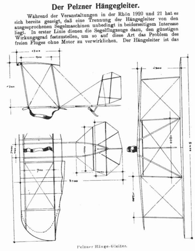

Michael A. Markowski decided to caption on page 64 of The Hang Glider's Bible a drawing regarding Pelzner's hang glider:
The last of the old hang gliders.
On page 63-64 Michael wrote:Derigged, they were small enough to be loaded onto a passenger train as traveller's lugggage at no extra charge; the parcel measured about 2.7 meters long and 1.3 meters high, but only 50 centimeters thick.
That pack as was will not fit the contemporary 2022 movement's target of under 5 ft; but someone may get to the tiny pack target with some mods of the Pelzner doppeldecker HG.
Michael comments in his book that Pelzner never "seems to have taken to the Sitzgleiter." His book has more Pelzner details.

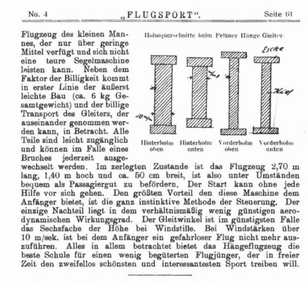

One source seemingly referring to 1920 or 1921: (ca. 6 kg Gesamtgewicht) for the weight of some hang glider, perhaps the first Pelzner; later he built larger refined versions of biplane hang gliders. But, if "6 kg" (approx 14 lb) was the deal, then that is inviting; what would careful CFRP do to the weight?
Pelzner had been an avid model builder prior to his building his man-carrying hang glider.
In issue of Flugsport in 1923: Note: That issue wrote about the 6 kg weight of the hang glider.
One primary resource might have misspelled his name; the paper has " W. Pelztier" on same record sheet that also had his name correctly spelled: Pelzner.
