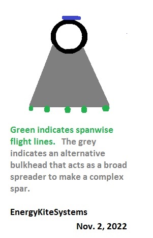

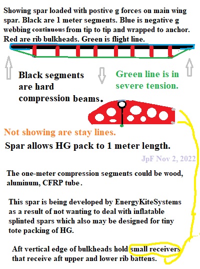

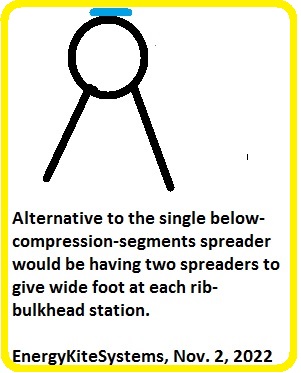

An option for a complex spar by EnergyKiteSystems toward "One-Meter HG Pack Club" is rehearsed in this post:
The rib-bulkhead part has a means to stay the position of the ends of the hard compression segment beams of one-meter length. The rib-bulkhead from nose to its truncated aft end is one meter. The receivers at the aft end of the rib bulkhead receives upper and lower aft rib battens; the battens will be in compression pushed by the HG's sail. The max stow length of the rib battens will be one meter. Wingtip wand will have max length of one meter, but may have an inserted extension that makes for an effective longer-than-one-meter wingtip, but packs will be at most one meter in length. The rib bulkheads will stack in pack along with compression beams and battens. Pack will hold kingpost and queenpost beams made up of beams no longer than one meter. High Hat parts will be less than one meter. Rigging lines will pack well also. Kp-Qp rigging will set wing position and allow mass reductions. The wing DS covering holds the shown complex spar in the sails' interior. The black vertical beam at each rib bulkhead is a hard compression beam. The number of rib-bulkheads may vary. The drawing suggests a 9-meter span for the wing, but this may vary per experiment; I will explore 5-m, 6-m, 7-m, 8-m, 9-m, 10-m versions as time permits.
Note: As these drawsings and notes have been suggesting the black compression segments be 1-meter in length, other lengths may be employed to build up a similar complex spar; e.g., instead of 1 meter, maybe 5-ft long segments. And further, say one chooses the 1-meter compression-element length; then still a rib bulkhead could be placed at the center of the 1-meter beam. A bulkhead is important to be at the ends of the compression element segments for anchoring the segments, but mid-segment bulkheads of lighter material may be used to help in airfoil formation. Maybe have two thin bulkheads in mid-beam between the key at-segmentation stations.
Anyone is welcome to develop HGs using the EnergyKiteSystems complex spar.
Caution: negative g loads are handled lightly; the close-to-compression-elements-hugging webbing uses only the cross-section of the compression elements as blocking mechanism; the Kp-Qp rigging aids in the neg-g loading demands; some stay lines and the DS-wing covering also helps some in the neg-g management.
This may also be used when no rib bulkhead is explored in which case the low feet of the two or more vertical spreaders could be tensionally bound or beam bound. Long flight tension lines would go from wing tip to wing tip and be grabbed by the feet of the vertical spreaders.
This drawing does not show the green dot that would be at the foot of the two or more generally vertical spreaders; the green dot would indicate the wing-spanwise flight lines that make up the complex spar.
