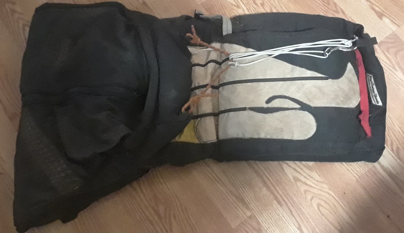

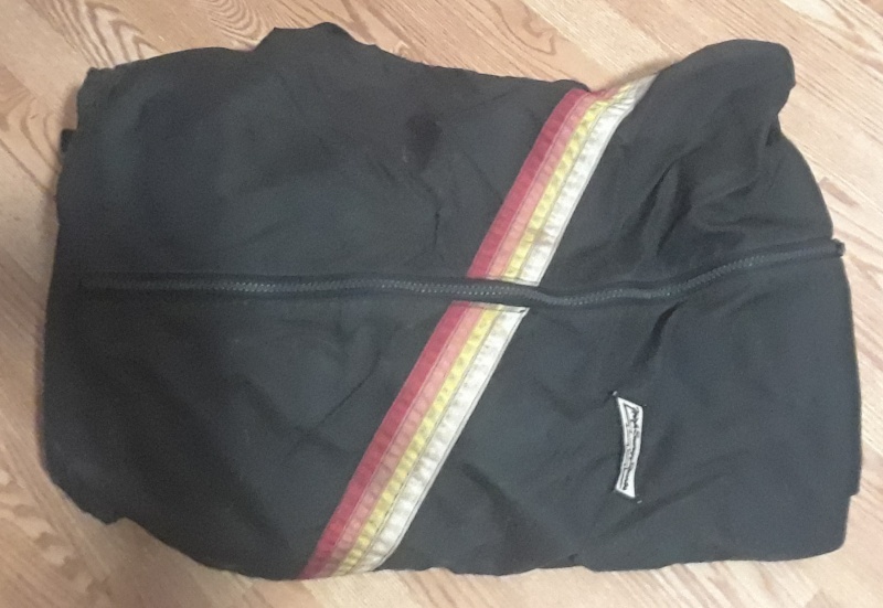

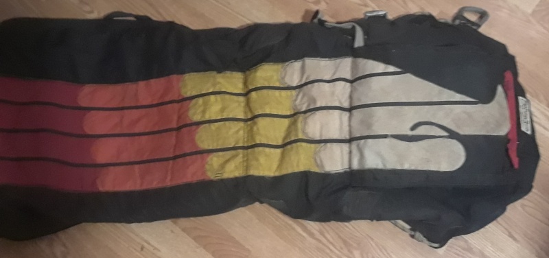

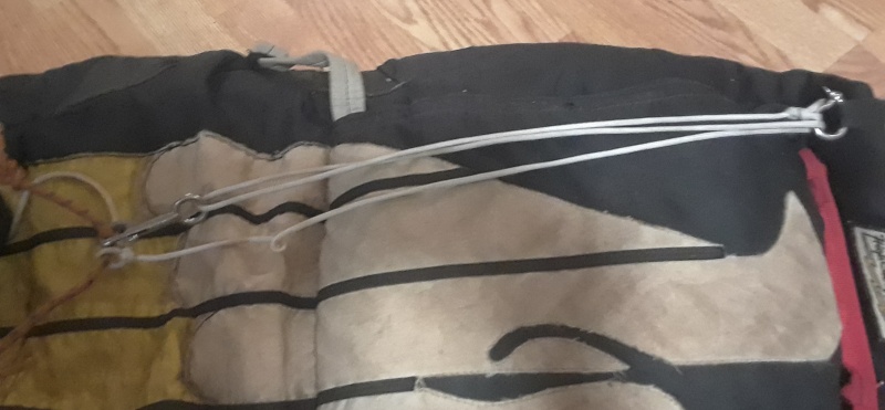

First, here's my harness both in the bag and stretched out:

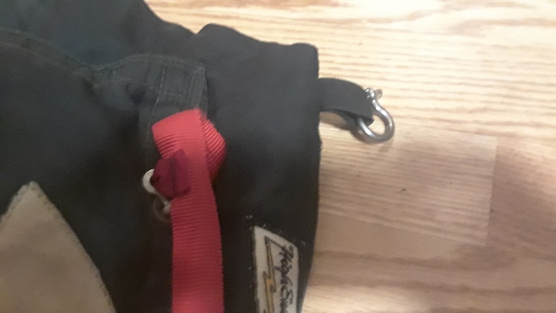

There's a little loop on the right shoulder where I've added a shoulder ring:

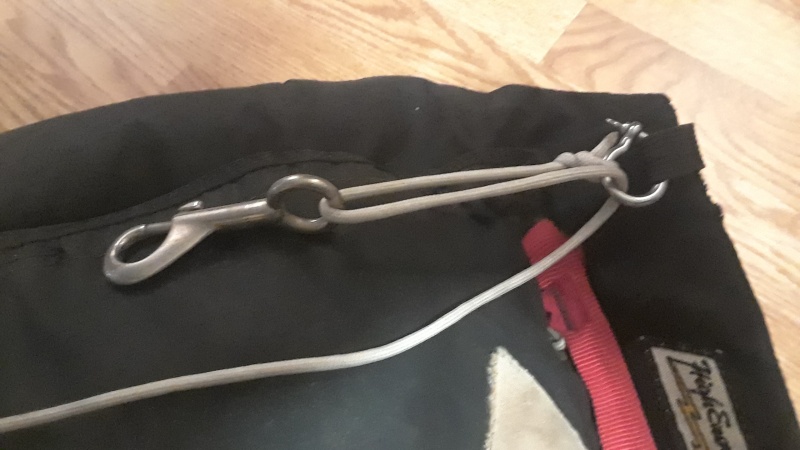

This lets me run a line (tied to the boot) through the ring, then through a snap hook, and then tied back to the shoulder ring:
When flying prone with the harness stretched out, the hook just hangs there at my shoulder and the line to the boot is stretched to full length. But when I need to pull up the boot (launch or landing), I can extend the hook and it pulls up the boot at a 2 to 1 ratio so I can clip it back to the boot:
In other words, the original line is now 3 lines cutting the distance by a third. That's enough to keep the boot from being stepped on during launch or landing.
If I wanted to get the boot even higher, I could pass the hook through the boot loop and fasten it back to the shoulder ring:
I don't think I've ever done that in flight, but it should be possible. More often (at least on launch), I clip the boot into the hook and clip that to my shoulder ring (not shown here). That keeps the boot as high as possible for the launch run (just as it would be without my retrieval line system).

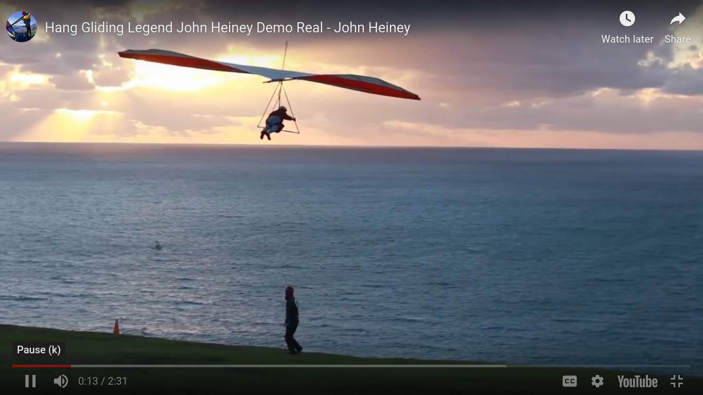

Here's a picture of me launching at Torrey (from John Heiney's Demo Reel) with the boot clipped all the way up:
Using this method leaves both of my hands 100% available for doing the important work of launching and landing. I don't have to be thinking about which finger is holding my boot string and when I'm going to release it. Here's the video of my launch at Torrey (about 10 seconds into the video):
