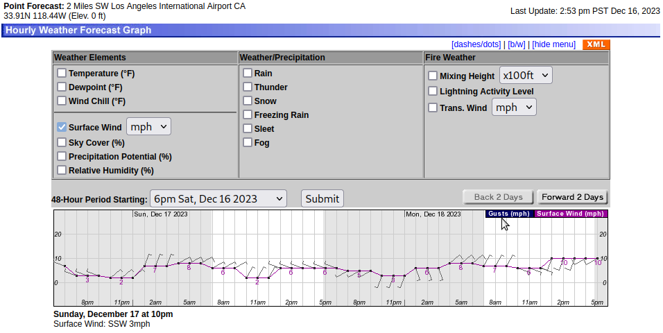

It's been nearly a year since I finished my "Blob Plot" Wind Visualization program, and I think it's about time to share it.
The attached file ("BlobPlot.htm.zip") is a ZIP file containing a single HTML file ("BlobPlot.htm"). You should be able to download it, unzip it, and double-click on it to bring up your web browser (Firefox, Chromium, Explorer, etc).
Initially, the plot will be empty, but if you select a site (such as Dockweiler in this example), then it should go to https://forecast.weather.gov to get the latest forecast as an XML file (assuming that you have an Internet connection). The program then parses the XML (shown in the first large text block), produces text versions of direction and speed (shown in last two text blocks) and draws a "blob plot" that looks something like this:

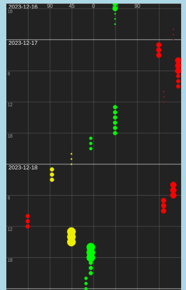

The plot typically shows the forecast for the next 7 days represented as a series of "blobs". The blobs are drawn to made it easy to visualize the wind at launch. Bigger blobs are stronger winds, and centered blobs show winds blowing directly in at launch. Blobs to the right of center show winds that would be arriving from the right of launch, and blobs to the left of center show winds arriving from the left of launch. The blobs are also color coded with green as most favorable, yellow as less favorable, and red as least favorable (usually not safe to launch at all). The forecast for the current date and time is at the top of the plot, and the most distant forecast (typically a week away) is at the bottom of the plot. Each date is listed, and a few times are also listed.
Because these plots are oriented to the launch direction at each site, you generally want to look for large green blobs near the center of the plot. For example, it's easy to see from a glance of the Dockweiler plot (above) that 2023-12-17 will have a light westerly wind in the afternoon and that 2023-12-18 will have a nearly perfect westerly wind in the late afternoon. You can see at a glance that rest of the week will have mostly strong winds from the south and southeast which are not generally flyable at Dockweiler (shown in yellow and red).

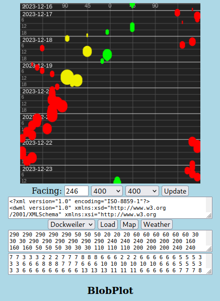

You can also zoom in by increasing the dimensions of the plot using the width and height selectors. These default to a size of 400 x 400 pixels, but that can be changed. The plot below shows the first two forecast days (2023-12-17 and 2023-12-18) with a vertical size of 2000 pixels.
That's the same data as the previous plot, but now it's expanded so you can see the individual blobs corresponding to the value of the forecast for each hour in the plot.
In addition to changing the plot size, you can also change the "Facing" direction. The default direction is the "normal" launching direction, but some sites have alternate launches. You can enter any heading to see the "blob plot" facing in that direction. All that does is shift the blobs (left or right). Feel free to experiment with it to see the results of facing different directions (try 0, 45, 90, 135, 180, 225, 270, 315, and 360).
You can change the site location by selecting from the list of sites and clicking the "Load" button. You can also visit the Google map by clicking the "Map" button (shown below for Dockwiler), and you can visit the forecast site (https://forecast.weather.gov) by clicking the "Weather" button.
You can add other sites, but you'll currently have to edit the actual program. If you look at the program in an editor, you should find the site dictionary that looks something like this:

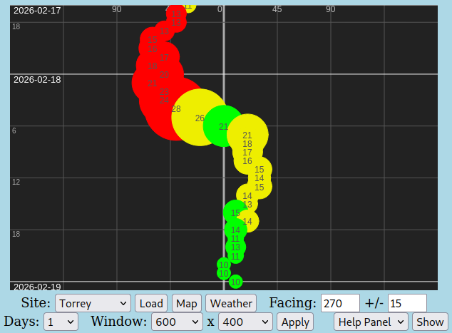

Postby Bob Kuczewski » Tue Feb 17, 2026 4:59 pm

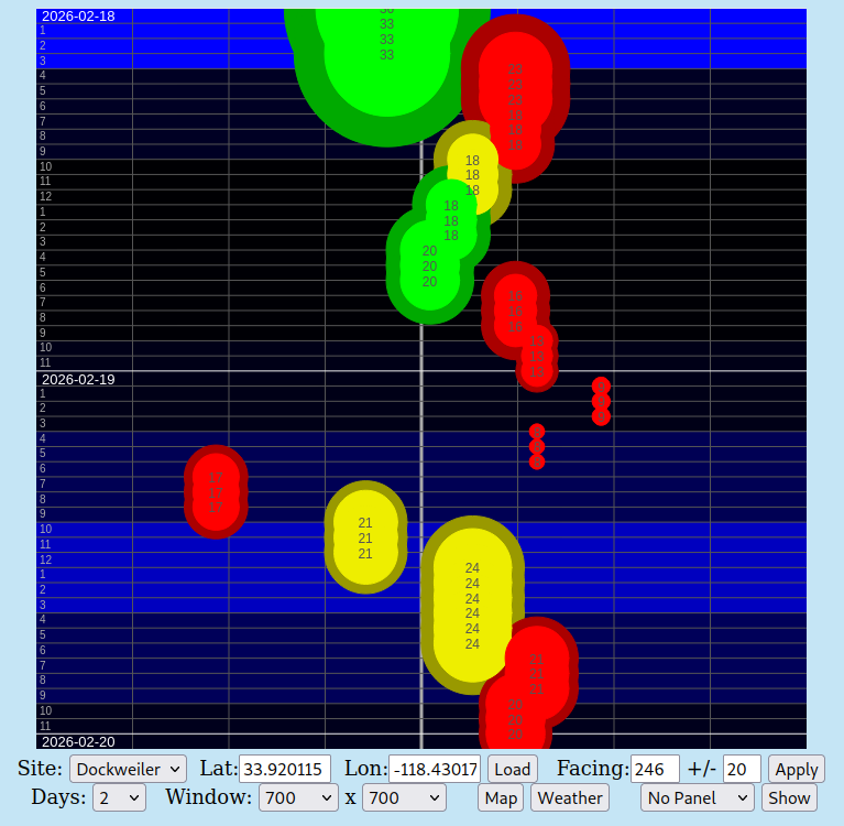

I added a few more improvements, and they are enough to consider this one as BlobPlot 2.0.
This new version is currently at: https://ushawks.org/weather/BlobPlot.htm.
Rather than use fixed angle ranges for green, yellow, and red, it's now a user setting in the "+/-" field following the "Facing" field. It's currently defaulted to 15 degrees. That gives the following default angle ranges:
      Green: 0 degrees to +/- 15 degrees
      Yellow: +/- 15 degrees to +/- 30 degrees
      Red: above 30 degrees from either direction
You can change the ranges by changing the +/- field from 15 to whatever other angle you find appropriate for the site and your skill level.
This version also allows you to choose the number of forecast days to view. Choosing "1" will show the rest of the current day along with the next full day. Each additional number (2,3,4...) will show additional days. Note that this is very helpful to see the wind speed numbers which will often appear on top of each other when all 7 days are shown.

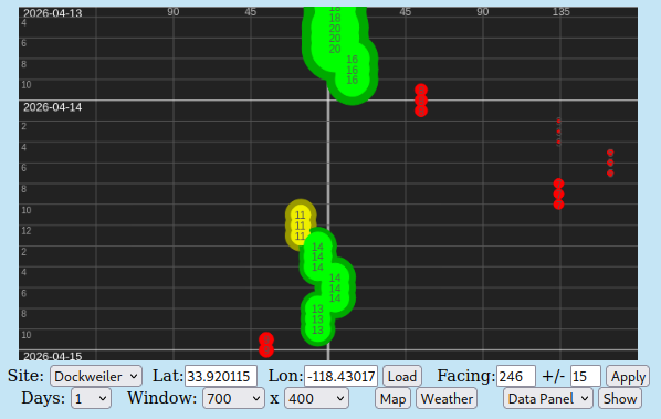

Postby Bob Kuczewski » Mon Apr 13, 2026 4:59 pm

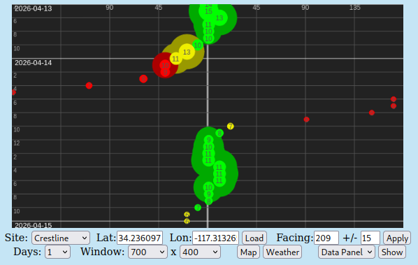

I've updated BlobPlot to version 3 which includes gust rings around the sustained wind circles. Here are some forecast examples from today.
Dockweiler:
Crestline:
If you compare the two plots, you'll find that the sustained wind is predicted to be considerably higher at Dockweiler. But the gust rings around the Crestline blobs are relatively larger (compared to the sustained wind speeds) than the gust rings around the Dockweiler blobs. This shows the typically greater variability (gustiness) of inland sites.

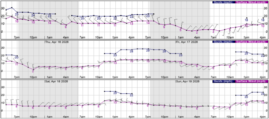

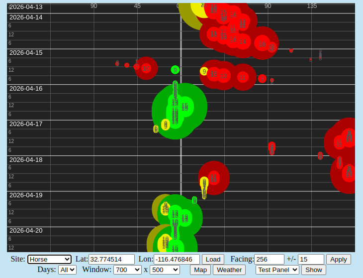

Here's a comparison between the 7-day BlobPlot for Horse and the traditional 7-day weather graph (which typically requires scrolling to view all of the days):
It's the same data, but much easier to assess with the BlobPlot.

Prior to this version, BlobPlot only showed the wind speed and direction. That worked pretty well in southern California ... until the rains came! The latest version (4.0) now shows the forecast precipitation in shades of blue. The brighter the blue, the higher the chance of rain.
I had to go back to a Dockweiler forecast I had downloaded in mid-February to find one with significant and varied rain to use as an example. Here's the BlobPlot of that forecast from February 17th, 2026 (forecasting the conditions for February 18th and 19th):
As you can see from the bright blue at the top of the plot, rain was very likely in the early morning hours of February 18th, 2026 (from midnight to 4am). If you look closely, you'll also see some very faint dark blue from 4am until 10am. That shows much less chance of rain during those hours. The plot background is nearly black the rest of the day which indicates nearly zero percent chance of rain.
Rain was also expected on the 19th. You can see there's a light chance of rain (dark blue) from 4am to 10am followed by a much stronger chance of rain (bright blue) between 10am and 4pm. Then the likelihood of rain is reduced (dark blue) between 4am and 10pm. Finally, the chance of rain after 10pm is very low (nearly black).
All of the other features of BlobPlot remain the same except for the addition of a new Test Panel. That panel has buttons that generate synthetic test data which can be used for testing without an internet connection. The Test Panel was mostly helpful during development, but it may have other uses. Here's a plot of some synthetic data with varying wind direction, varying wind speed, and varying probability of precipitation:
