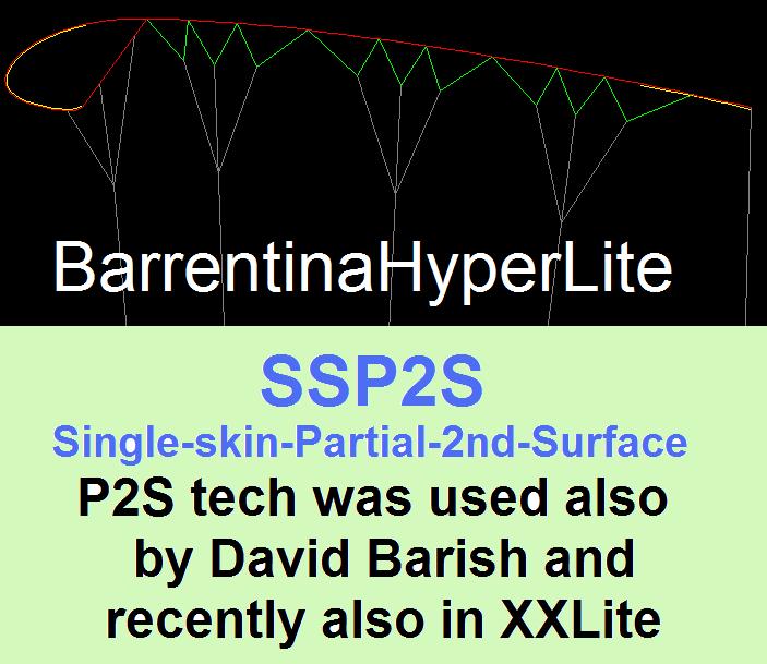

Thin-sail material is often used to make PG and HG wings skin geometric airfoil shapes. :|
When an airfoil is thin and same thickness as thin sail material used from LE to TE, flat or curved chord, aviation culture seems to know such as a single-skin-single-surface wing (neglecting that there is still an actual lower surface to the sail material). But differently when the airfoil has thickness different in leading regions compared to thickness in aft regions, then a "second surface" is developed, either partially along the chord or fully aft along the chord to the TE.
David Barish's Sailwing had a distinct partial second surface developed by cut-and-sew tactics; such partial second surface allowed a filling that thicked the resultant airfoil and such reduced the pitch sensitivity of the wing and collapse sensitivity of the wing. The important partial second surface (P2S) was key to safety and pitch and collapse matters. The sharp sail-thick leading edge of true single-surface kite and kite-gliders is so very different from the Barish offer in the early 1960s. The P2S tech is in public domain and has been being explored decades in HG and OutLeader (Dave Culp) and now by Pere Casellas and others (findable in FoilDesign group). P2S wings are mechanically siimply not SS (single surface). HG use culture has relaxed "single-surface" until crossbar is covered; but that language misses many opportunities for efficient discourse, as the handling of just what is done on the LE tubes and the covered cavity after of that by sail on undersurface (thicker pseudo LE, fillers, D-tube, etc., even if crosspar is not enclosed). Differently is the Platz, the Porta-Wing, and other super-sharp LE gliders. It has been my hope that the call out of % for P2S HGs become text and discussion norm, but the ongoing relaxion in HG at the user level probably won't change; once the crossbar is enclosed and perhaps forming ribs or battens support lower surface sail to 60% chord or 80% chord or 100% chord, then DS is norm language.
In PG, the XXLite has first text out as "single skin" and ALSO "single surface" which misses big win opportunities for OZONE and misses the gain of efficiencies for safety, commerce, history, and discourse. It is fully clear that the XXLite wing is P2S and its partial second surface is a Barish plus for the prototype offer. I hope that I will not be the only one asking OZONE to early now sharpen their language to get the wins for them and others that will be dealing with their language. The P2S tech is not patentable, as P2S tech is in public domain. But various makers can bring on products in time using P2S tech for HG and PG.
Discussion is open. And, if you are moved to do so, consider asking OZONE to drop the "single surface" even though keeping "single skin". I do not want unaware builders to see and hear "single surface" and just throw together a super-sharp-edged LE sail and jumping off a tower. I would hope they would know about P2S; and OZONE could help on this matter, especially because of their present status in wing provision.

Single-Skin-Partial-2nd-Surface technology :wave: is in public domain
and is being used by :!: BarrentinaHyperLite and others like XXLite. :shock:

Your posts always get me thinking about something!! This is not really on topic, but your drawing above got me thinking about a few things.
First, it got me thinking about adding stiffening in PG wings. I know that kite surfing wings have sealed inflatable cells that make them substantially rigid. I've always been surprised that such semi-rigid structures haven't found their way into paragliders. I have to believe that it's been considered, and it makes me wonder about the drawbacks. I had always thought that sealed tubes running chord-wise would be like battens in hang gliders. But your drawing got me to thinking about a single spanwise tube at the leading edge - just above the pressurization openings. I'd be surprised if it hadn't been tried, but I haven't seen any published results.
Your posted drawing also got me to thinking about how the speed bar on a paraglider pulls proportionally more on the leading edge to effectively lower the angle of attack. I was mulling over how that's so much different from the way we control pitch in a hang glider. But then when I thought about the geometry, it turns out that it's really the same!! After all, by shortening the forward lines, the geometry is actually changing bringing the pilot's weight forward relative to the canopy. Of course the word "relative" is important, and because the pilot has so much of the mass, it's the canopy that ends up responding far more than the actual movement of the pilot's CG.
