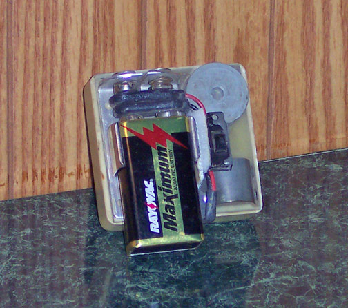

When did the Snooper first come out... 1990? I got one of the first ones (#13) and flew with it until selling it 2 years ago.
At first, I hated it. The fast and slow beeping and booping drove me nuts. Trouble was, I didn't know how to use what it was telling me. Took me 3 years to finally understand it, and it made a whole lot of difference when I did! It allowed me to know better the shape of a thermal and know where the stronger spots were without the lag time of a vario.
I put a small piece of duct tape over half the piezo speaker opening to dampen the sound a bit, just enough so I could still hear it above the wind, vario and radio chatter. It helped provide another piece to the puzzle.
Worked with a South African pilot -- Werner Terriblanche -- who was trying to make his own. The model he sent me for testing was visual-only with red and green lights. I worked with it for half a season but finally had to put it away because there is SO much visual in flying that trying to differentiate the lights (hell, just noticing them) was nearly impossible. Totally lost touch with Werner so I don't know what ever happened to his design.
- Peter
