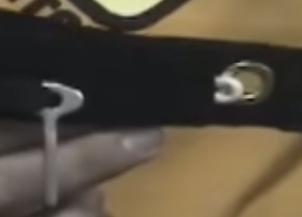

On the video shown it is extremely important to note that this type of release has a pocket for the release pin end to be inserted after going through the first string to be released.
If the release pin end did not have a pocket to fit into, the release activation cord, with too much slack, could catch under the pin end making it impossible to release.
The pocket that the release pin tip fits into can not be absent.
If someone would use this video to pattern a home made release they must understand that much planning went into this release and the slightest deviations in a home made copy may result in a release failure.
Also not all that clearly depicted is the need for each string release to be of a smaller diameter cord as it progresses toward the release pin.
Using release strings of the same diameter cord will eventually result in a capture causing the release to fail.
To date there has not been made on planet Earth a hang gliding tow release that is one hundred percent infallible.

Three clips from the video:
Screen Shot 2015-05-05 at 12.41.34 PM.png (69.96 KiB) Viewed 12156 times
Screen Shot 2015-05-05 at 12.42.40 PM.png (35.93 KiB) Viewed 12156 times
Screen Shot 2015-05-05 at 12.43.13 PM.png (38.75 KiB) Viewed 12156 times
