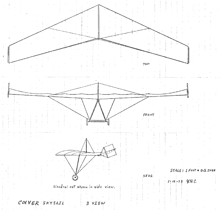

Every once in a while I dig through my old HG boxes and files and I see things that I didn't remember were there. So I decided to participate in this HG history section by starting this section to deposit copies of drawings or photos pertaining to the Skysail and Variometer, my two contributions to what with the passage of time became part of the sports history.
Some items may already be in other sections of the US Hawks forum but this will eventually be a concentration of the historical stuff pertaining to those two original designs.
The first item deposited here, I stumbled across today, is a copy of a three view drawing I made when the Skysail was one year old. I did not remember that I had made this drawing.
As noted on the drawing it is scale 1 foot = 0,2". The background grid is 0.2" squares.
Skysail 3 view 1-10-73.PDF
(764.73 KiB) Downloaded 674 times
(764.73 KiB) Downloaded 614 times

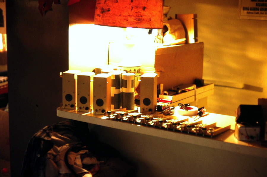

Postby Frank Colver » Fri Jul 03, 2015 9:01 pm
Here's the variometer production line in the early days.
Vario Production Line spring 1974 R.jpg (229.73 KiB) Viewed 17857 times

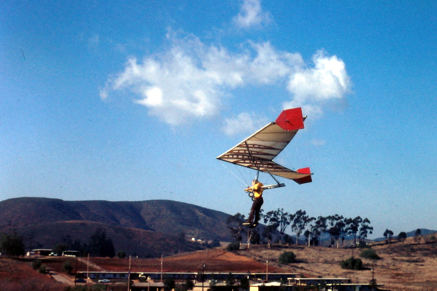

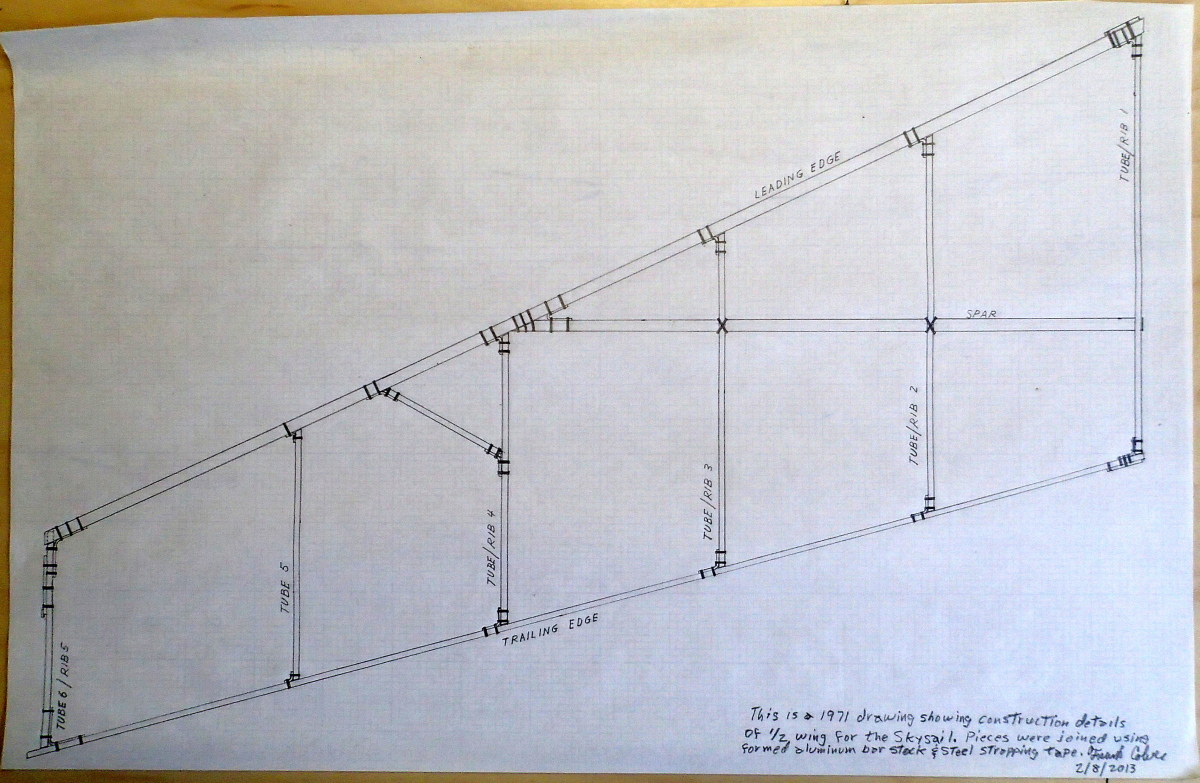

Postby Frank Colver » Sat Jul 04, 2015 11:28 am
Skysail frame plan. Drawn in 1971 and photo copied with notes in 2013.
Photo is Ernest Feher at the controls in Spring of '74 at the "Vineyard Rd" hill site in San Marcos (we called it Vista at the time). This was a Richard Miller flying site. The hill is still undeveloped but the landing area is covered with houses. A cement water tank on top has since been demolished.
Note: Photo shows parallel bars which was the last design configuration the wing took. much easier to ground handle.
I can't believe I taught myself to fly (but I did) on this wing, which was a sports car compared to the other gliders at the time I was learning in early '72.

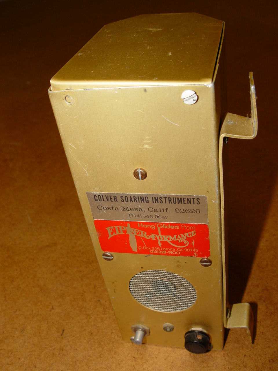

Postby Frank Colver » Sat Jul 04, 2015 11:50 am
An early production version of the vario. Judging by its condition this was most likely one I got back for repair. Maybe it's the one that fell 1500 feet at Elsinore and survived by going through a high bush. Its owner located it by hearing the tone it was sounding as it lay under the bush.

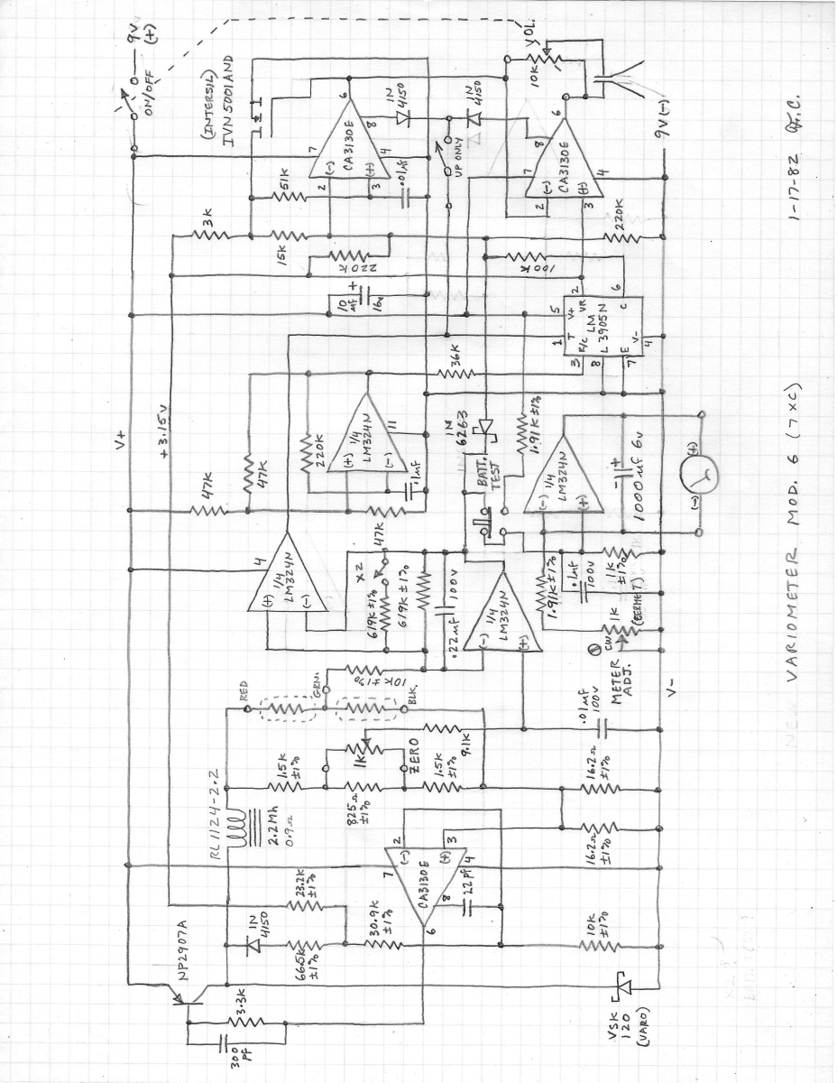

Postby Frank Colver » Sun Jul 05, 2015 11:40 am
This is top secret information declassified as of now.
This is the schematic of the latest model #6 (model 7XC) that was produced and the one that Wills Wing produced after I turned over the production rights to them. I went on to design one that used a 9v battery, instead of four AA cells, and used much less current, but it was never produced. In that model I changed from the sensor bridge being a voltage divider to a constant current feedback divider. It exhibited less drift over time and a more linear output.
Last Production Model 7XC Schematic.JPG (441.5 KiB) Viewed 17837 times
Re: Colver Skysail & vario stuff
Postby Frank Colver » Sun Jul 05, 2015 12:09 pm

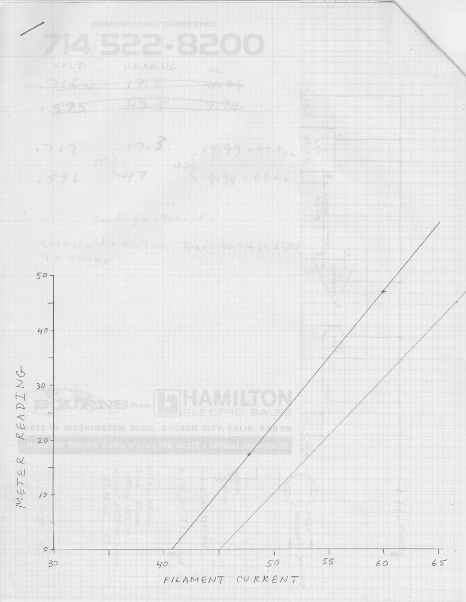

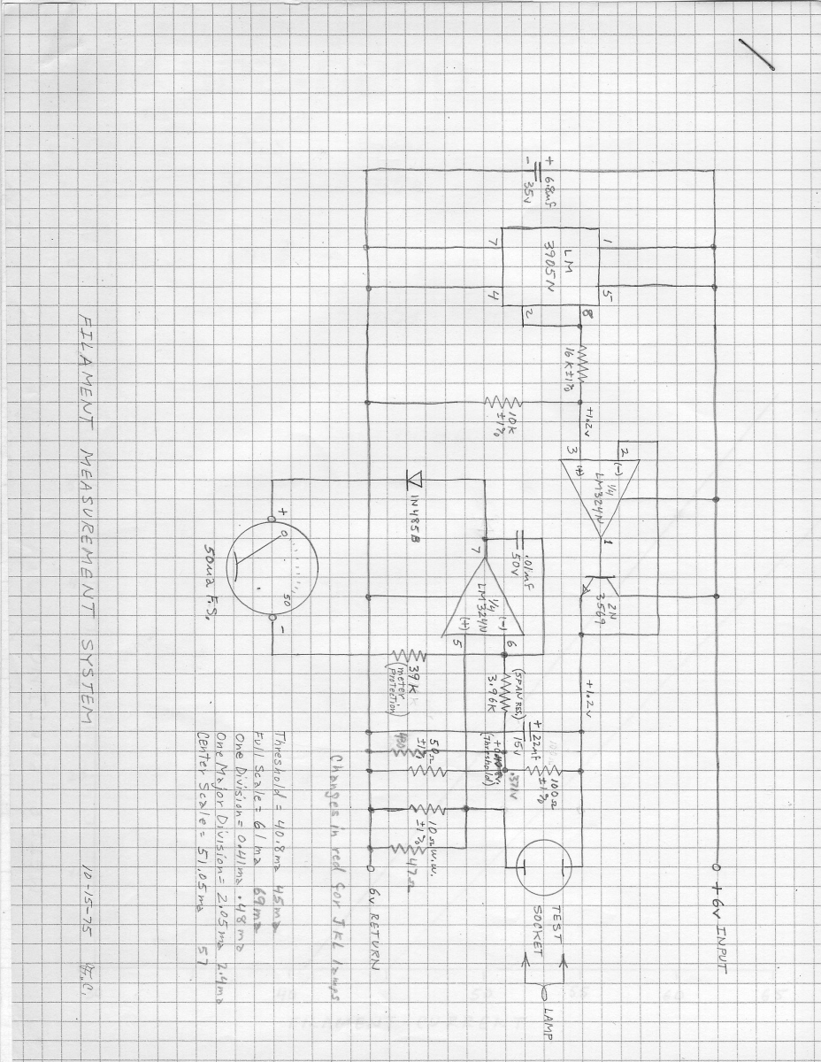

More top secret information declassified now.
The sensors were dual "hot wire anemometers" that had to heated elements positioned next to each other in an airflow from two nozzles and air exiting or entering a bottle due to ascending or descending would flow through these nozzles. The wire in the air stream shadow of the other wire would not cool as much as the wire facing the air stream and the balance of the bridge would shift. Thus the wire changing the most would indicate whether air was entering (descending) or leaving (rising) the insulated bottle.
The sensor elements were the filaments of tiny lamp bulbs. I developed a system where I could break the bulbs to expose the filaments to ready the lamps for construction of the sensors. If the manufacturer of the lamps didn't make a gas tight crimp between the wire and the filament then the tungsten filament would oxidize over period of time and the contact would fail. This was the main cause of "infant mortality" in new varios. In order to weed out as much of this problem as I could, in a reasonable amount of time, I would bake the newly exposed bulbs in a low temperature oven overnight and then they would sit for a couple of weeks. When I was ready to start using them, I would run each one through a test system. Not only did it identify bad parts but I also paired them, within certain parameters, to use in the sensor assemblies. There were times when I would have to trow out about half of the bulbs. Obviously, over time, I determined the most reliable manufactures to purchase from.
One German lamp manufacture claimed to weld the filament to the wire posts. Those were very expensive lamps but I figured that if I didn't have to trash any I would be ahead in the long run and fewer varios would experience failure. It turned out that I had a very high failure rate when testing those lamps. When I told the sales rep that the connections were not getting welded as claimed, the factory replied that was impossible because it was done automatically by machine and therefore could not be in error (hmm.... sounds typical German design philosphy doesn't it?). The factory didn't even check to see if there might be something to what i was claiming. Just blind faith in their automatic process to work correctly. Of course I quit buying those lamps.
Filament Test System.JPG (536.48 KiB) Viewed 17837 times
Filament Test Current.JPG (345.15 KiB) Viewed 17837 times

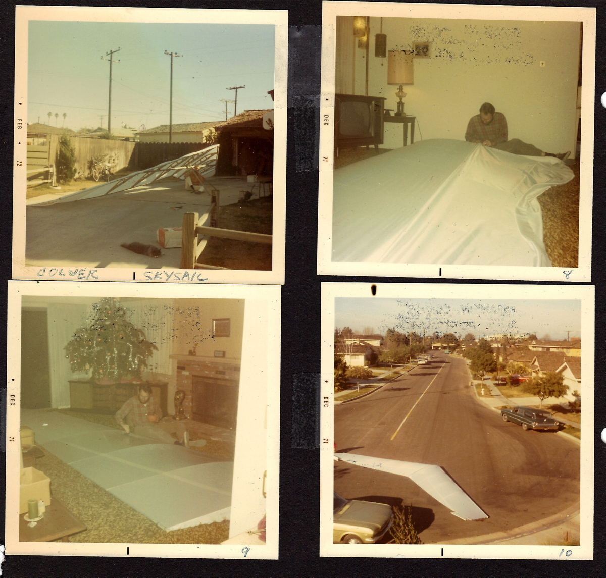

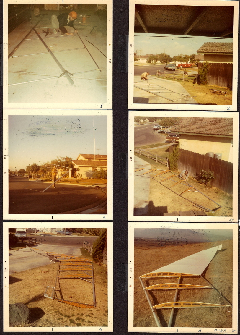

Postby Frank Colver » Tue Jul 07, 2015 10:24 pm
Here are photos taken during Skysail construction in 1971. Construction started on November 5, 1971 and the wing was first taken out to fly on January 22, 1972. The up only ailerons were quickly abandoned in favor of tip drag rudders when it was discovered that the glider wanted to pitch up when a turn was initiated.
Building the Colver Skysail 1 R.jpg (537.91 KiB) Viewed 17827 times
Building the Colver Skysail 2 R.jpg (643.9 KiB) Viewed 17827 times
