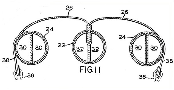

Wayne A. Sebrell
https://www.google.com/patents/US3957232
Consider going beyond Sebrell by having each chamber be itself a splinted encased airbeam.
HG pioneer Roy Haggard:
https://www.google.com/patents/US6082667
Roy Haggard, an early Otto Member of Self-Soar Association wrote:An inflatable wing is taught by McDaniel, U.S. Pat. No. 1,905,298. McDaniel includes multiple tubular spars and a flexible skin. However, his teaching does not include adequate means to support the skin in a smooth, accurate airfoil contour. The improvements of this invention include (1) the use of open cell foam with its ability to inflate to a smooth, specific contour under pressure and (2) the foam used in combination with high pressure tubular spars. The optimal use of a pressurized tube as a control-surface-actuating torque tube is also an improvement.
Note: Roy's teaching for the inflated spar included an urge of 50 psi which is consistent with a dependency on the simple non-tensairity beaming. In splinted cable air beams using compression elements firmed to the cased bladder, the inflation air pressure may be much reduced.
