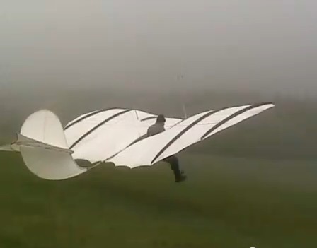

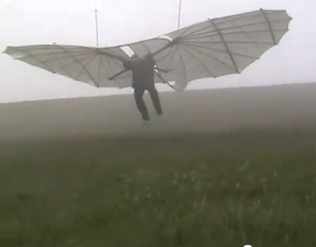

Stephan and myself trying out one of his replicas on the Wasserkuppe :- http://www.youtube.com/watch?v=mpDrGLF51SY

ARP wrote:Stephan and myself trying out one of his replicas on the Wasserkuppe :- http://www.youtube.com/watch?v=mpDrGLF51SY
Great footage:
But I'm glad I watched it to the end:
How did it feel to imagine yourself a hundred years ago taking man's first steps into the air?

One or two of the flying sequences from the film could possibly be real the rest is staged camera work and a model in flight. The Lilienthal flying position requires the pilot to support himself on the forearms with the shoulders against a back stop. The pivot point is the shoulder joint linked via the to the elbow to the airframe. The glider used at the Wasserkuppe did not have the back stops fitted which was a mistake as it allowed the pilot to move too far back leaving the biceps to take the body weight alone. Not something anyone can do for long. The last clip of the Wasserkuppe scene I have moved too far back and the forearm rest broke resulting in a stall and then a nose into the ground. The stall on the Lilienthal glider is very sharp so it is important that the pilot's upper body remains foreward and only the lower half is used for the pendulmn control.
On the early bamboo Rogallo type I used parallel bars which allowed whole body movement to find the balance point of C of G to the centre of lift ( the sweet point mentioned by Barry Palmer) and then swing the lower body by "body English" for manoevering control.The Chanute replica, built by Stephan, had parallel bars and control was in the same manner.
