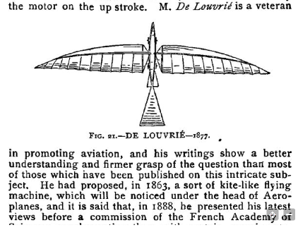

--------------------------- E.g.
Louvrie called his design "Anthropornis"
De Louvrie -1877.png (87.46 KiB) Viewed 16362 times
part of official page 32 (file page 40)
