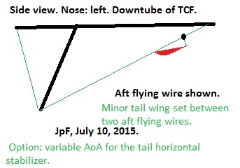

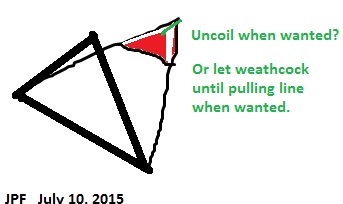

Postby JoeF » Fri Jul 10, 2015 8:29 am
ARP,
Two aft flying wires formed a base to set a sail triangle at aft keel region; negative lift device.
I am having no success finding a photo showing the Lake SailFeather. Quick add to early standards.
JpF wrote:Guestimate today:
Red sail device sketched. Aft two flying wires form base for the small sail. The W. Simon like triangle control frame or A-frame (1908) is sketched showing the attachment of the aft flying wires.
Consider such reefable; that is, have such rolled up; then when wanted: Pull a string through pulley at aft keel to open the coiled small sail. Employ when wanted. Or trigger full uncoil on urgent need.
Two ways to have controllable feather?

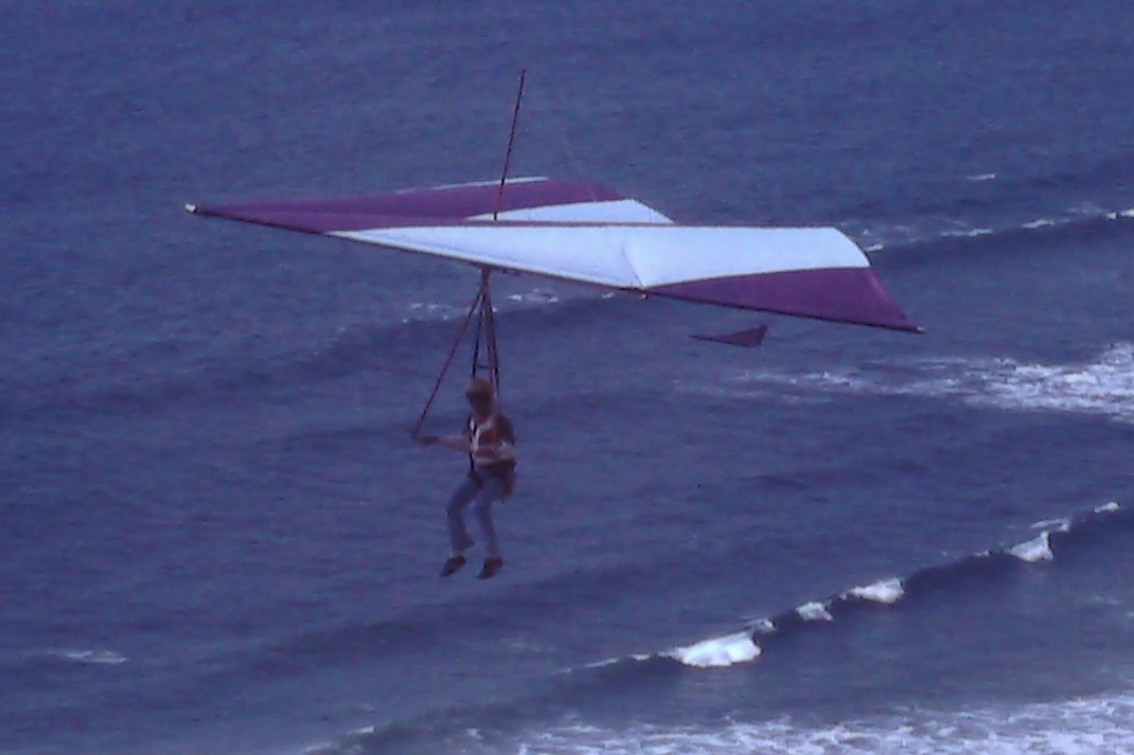

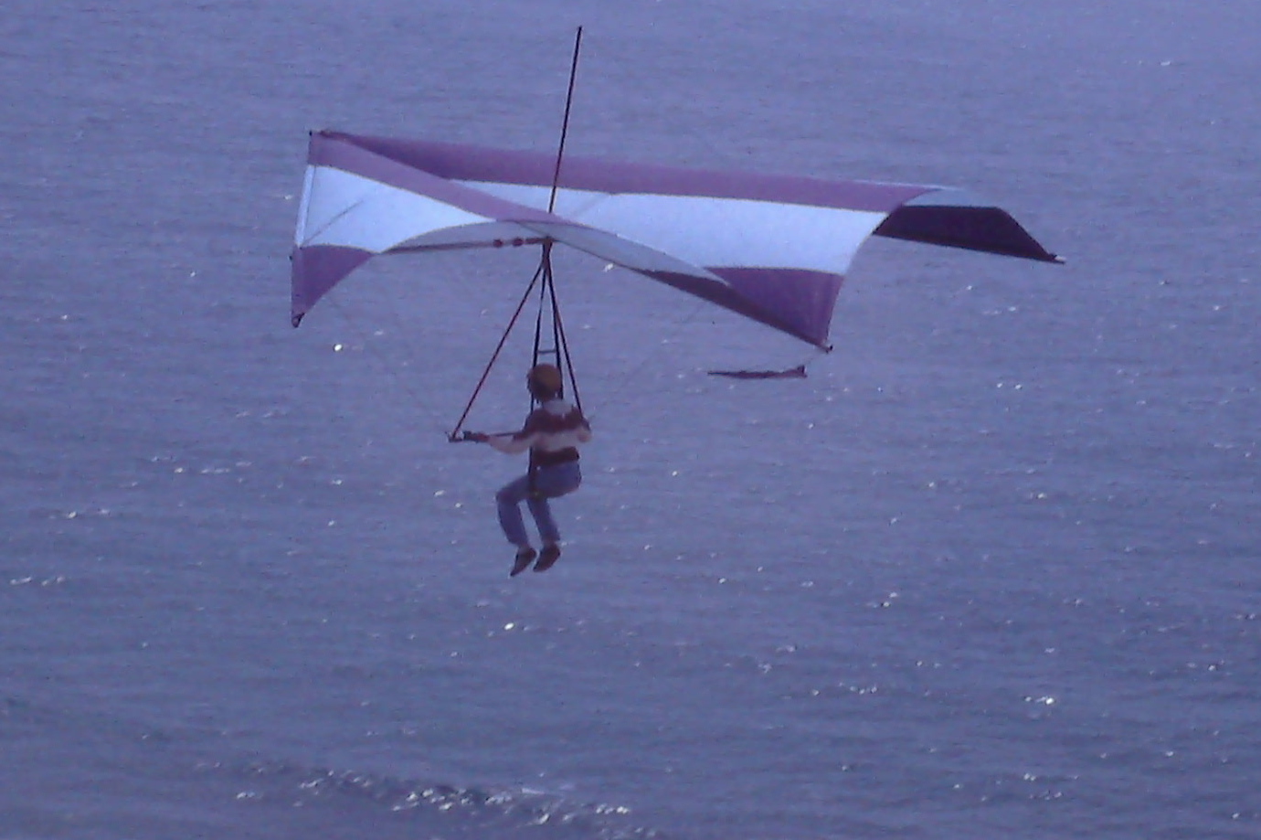

Postby Frank Colver » Fri Jul 10, 2015 10:35 am

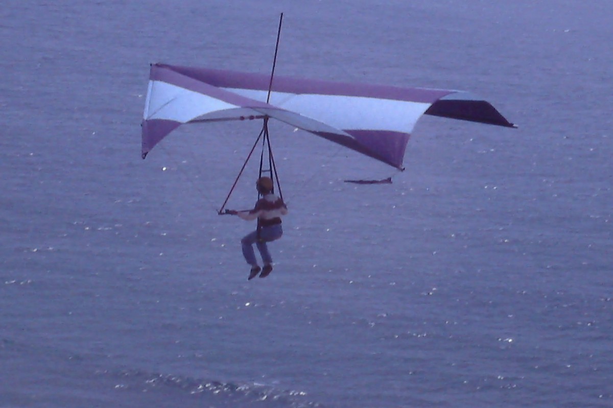

Gosh Joe, why didn't you ask? Didn't it occur to you, that if I used one I might be able to find a photo? ;) Actually, of all the photos I have of my Flexi Floater I do have very few that are good shots of the "feather".
Here is Dave Kilbourne flying my Flexi Floater at the 10th anniversary meet at Torrey, May 23, 1981. The photo is fuzzy because it is cropped from a distant shot, but the Sailfeather can be clearly seen on the rear wires (which don't show). It quickly clips on the wires which have a couple of stop sleeves crimped on to prevent it sliding back and the rear point of the Sailfeather is attached by a string. This allows the Sailfeather slack to be adjusted depending on how much up-pitch force is wanted. My Sailfeather was an exact copy of John Lake's design, so performance would be comparable.
Dave Kilbourne, my Flexi at Torrey.jpg (205.6 KiB) Viewed 6216 times
Here's another view edge-profile to the Sailfeather.
I picked these photos, instead of static ground shots, because they show everything under flying loads. Besides it's nice to post shots of Dave in better times of his life.
About trim: I should have rigged the base tube farther forward after adding the Sailfeather. Notice how far forward Dave is in trim glide. I was quite a bit heavier than Dave but my trim position was still pretty far forward. That limited my ability to get the nose down quickly when I needed to. :o I almost stalled into Little Mountain CA because of that. I had my stomach against the base tube and my feet straight out on that occasion and on several others. I have no idea why I didn't re-rig the control bar. One of those stupid things that fortunately didn't kill me. It's still in that position today. :problem:
FC

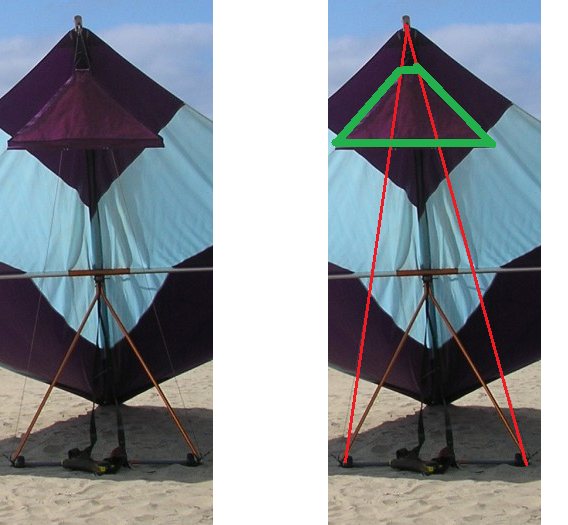

Postby JoeF » Fri Jul 10, 2015 11:21 am
And on May 23, 2015, Frank Colver showed the SailFeather on his Flexi-Flyer:
It appears Frank installed a leadng edge beam that is broader than the separation of the aft flying wires at the sailfeather L.E. station.
Confirm, Frank???
