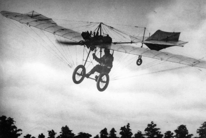

When more is known about this craft and pilot, then perhaps a topic thread would be suitable. Anyone?
http://i670.photobucket.com/albums/vv70 ... 1e50f4.jpg
The prone position with parasol wing with A-frame, and wide extended basebar wheeled seem interesting.
Year? Pilot? Designer? Trials?
One site hints that the scene might be pre-1914, but I do not have confirmation.
The caption there is:

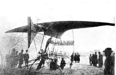

Dorner-Begas Gleiter of 1908.
A parasol design started by Diplom Ingenieur Hermann Dorner in the spring of 1907 as a glider with a possibility of attaching an engine at a later time. He was financially assisted by Gottfried Begas, the son of the German sculptor Reinhold Begas. The machine was flown by towing it behind a horse and flights made were about 80 meters in distance at a maximum height of 10 meters. Dorner himself flew the machine and as can be seen in the photo, lay horizontally in the same way the Wright brothers would lie on the lower wing of their biplane gliders or early motorized biplanes.

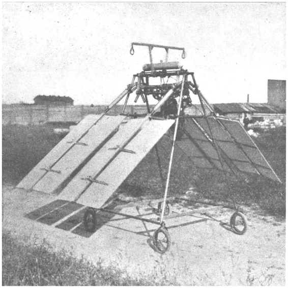

Maybe some clues from a Dorner III Image
[[Not to lose a neat found page on Hans Grade that features pilot hung and A-frame and more: "Stunt Plane by Hans Grade (archive Eberhard wreath)"
http://www.fliegerweb.com/geschichte/fl ... exikon-650 ]]
Included at that page, see again the double A-frame, power on or off, rightside or upside down ...got you covered for control and landing:
German wiki:
Hans Grade auf seinem Eindecker Nr. 1 (1909). Pilot is hung from wing; he places his feet on basebar of A-frame; this is a bit different from the 1908 Breslau gliding club's A-frame pilot arrangement that forms some of the early tech for that which is common today for hang gliding.

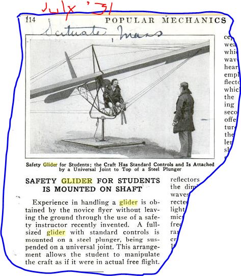

An A-frame in glider trainer in July 1931 issue of Popular Mechanics:

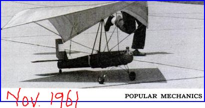

November issue of Popular Mechanics in 1961
A-frame for the hang glider that would glide when power was off:

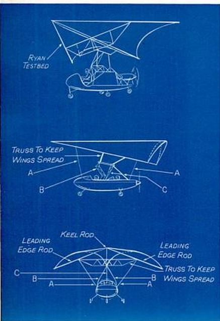

Flying, magazine, July 1961, article page 22 and following.
Three rod and spreader beam, then below A-frames to hold hung masses. Power-off (as always) gives glider.

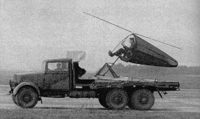

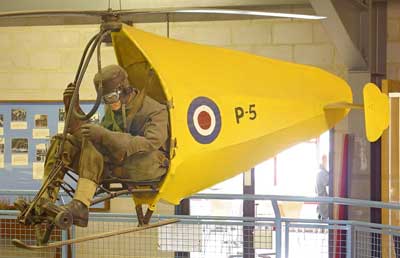

Some versions had the full A-frame stick as shown that was frame-integrated with wing. Craft was able to kite and hang-glide when disconnected from the kiting tether. Rotachute.

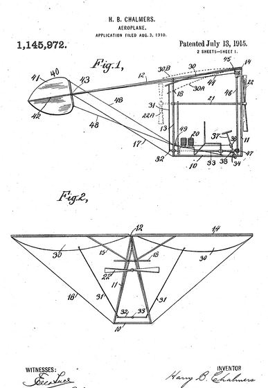

Re: A-frame in Aviation
Postby JoeF » Sat Dec 13, 2014 10:49 pm
Filed in 1910
US1145972
