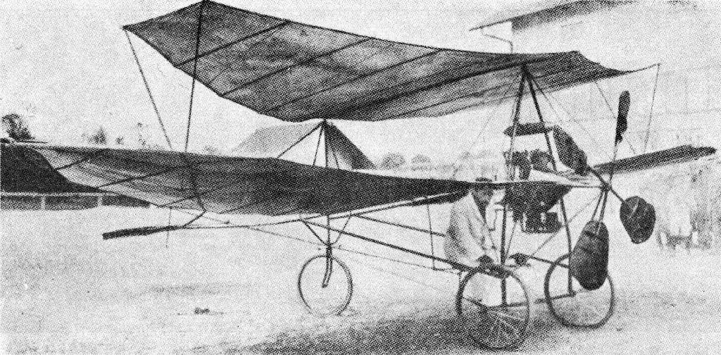

Someone wrote:ELLEHAMMER (1905). On 12th September, 1906, this machine made the first free flight in Europe. On 28th June, 1908, it won the prize at Kiel for the first flight in Germany (distance, 47 m.) It was a tractor biplane with a revolving Ellehammer motor. It also had a pendulum seat as a stabilising device.
Engine off: glider with pilot hung by tension behind the A-frame.
A-frame, pilot hung tensionally behind A-frame. Upper battened sail. Glider when engine is off.

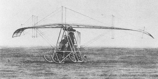

Study of A-frame and rigging. Dunne-Capper. Year: 1911. This is about three years after the most-simple hang glider with A-frame cable-stayed with pilot hang for foot launching (no motor, no skids, no wheels) with a most simple battened wing of sail (as we have in many hang gliders of today).
Here in the Dunne-Capper there is seen three skids and the pilot behind A-frame. Wire-profile drag is high on this effort.
