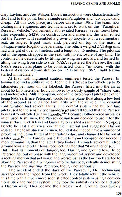

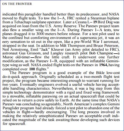

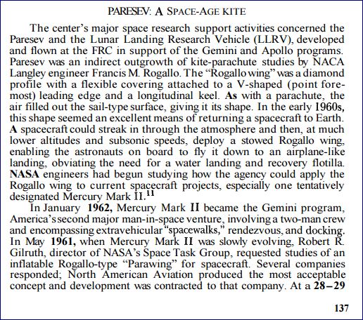

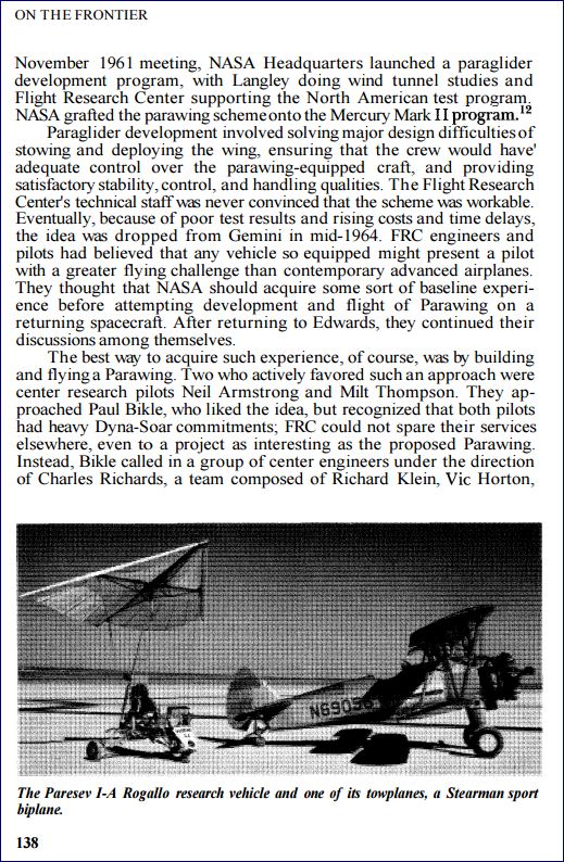

Quote from book On the frontier: flight research at Dryden, 1946-1981, page 139:
"The best way to acquire ... experience, of course, was by building and flying a Parawing. Two who actively favored such an approach were center research pilots Neil Armstrong and Milt Thompson. they approached Paul Bikle, who liked the idea, but recognized that both pilots had heavy Dyna-Soar commitments; FRC could not spare their services elsewhere, even to a project as interesting as the proposed Parawing. Instead, Bikle called in a group of center engineers under the direction of Charles Richards, a team composed of Richard Klein, Vic Horton, Gary Layton, and Joe Wilson. Bilke's instructions were characteristically short and to the point: build a single-seat Paraglider and *do it quick and cheap.' All this took place just before Christmas 1961. The team, now totaling nine engineers and technicians, set to work on this *Paraglider Research Vehicle,' conveniently abbreviated Paresev. Seven weeks later, after expending $4280 on construction and materials, the team rolled out the Paresev I. It resembled a grown-up tricycle, with a rudimentary seat, an angled tripod mast, and perched on top of the mast, a 14-square-meter Rogallo-type parawing. "

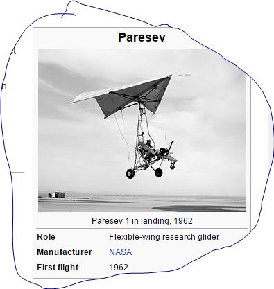

https://en.wikipedia.org/wiki/NASA_Paresev
NOTICE CAREFULLY: The spending was not just for the wing -parawing- : the standard four-boom item that NASA let Rogallo further explore professionally within NASA following decades of his hobby research on the wing sector, but for the wheeled pilot-holding payload hung beneath the wing. My guess from the parts involved, that most of the funds were spent on the parts protecting the hold of the pilot ... valuable payloads, indeed. Someone might find the costing sheet for that January 1962 build effort ... just how that $4,280. was spent. Neil Armstrong is welcome as an honorary U.S. Hawk, in my tally, as he co-initiated the Dryden FRC hang glider project, as well as hang glided at least one of the serveral versions of the FRC's hang glider in project PARESEV. It is cool to have Neil in our hang gliding community--- first man on the Moon, approximately 7 years after spirited the start of the FRC hang glider flight-training program.
It would be interesting to know the coins spent for the wing and the coins spent for the pilot-holding payload items. The hang glider with its hung pilots were to be towed up for launching into hang gliding flight.

Notice that the stowing and in-space or near-space deploying of the hang glider paraglider was a huge challenge,
not the merits of the wing in open hang glider format. The hang gliding could occur just fine, but the mechanicals of
getting the hang glider paraglider for tight stowed format to full free-flight format were apparently not competing
well enough or fast enough with well-tried canopy parachute technology for bringing to ground cherished payloads
and astronauts.
Notice the multi-site and multi-company indicators for 1961 matters surrounding the parawing, paraglider (hang glider) ..
Each of those other sites and teams and companies had 1961 significant involvement with the subject; their works in their teams
formed package for 1961 that became more robust package for the 1962 scene. It will be shown that scores of people were
thinking about the hang glider paraglider. Those in those teams living and working in 1962 were part of the larger hang glider world
in their own ways, interests, ideas, patents, discussions, memos; the full body of related information in 1962 in the large radiance of NASA and
associating companies forms quite a large body of information to study.

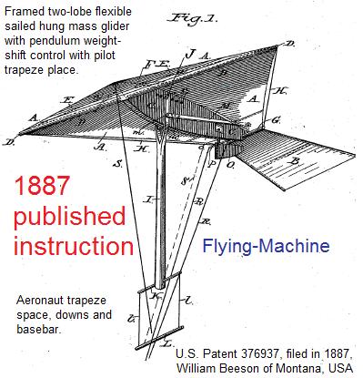

Available to those skilled in the hang glider and aviation arts in 1962 was the functional technology disclosed to the world by William Beeson in 1887.
Here is a tease on Beeson that provides foundation for trapeze in hang glider of two lobes in wing's sail:
My vote is to have William Beeson as an honorary member of the U.S. Hawks. He lived in Montana, USA.

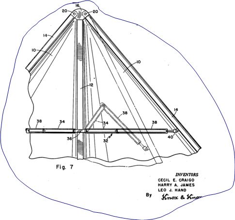

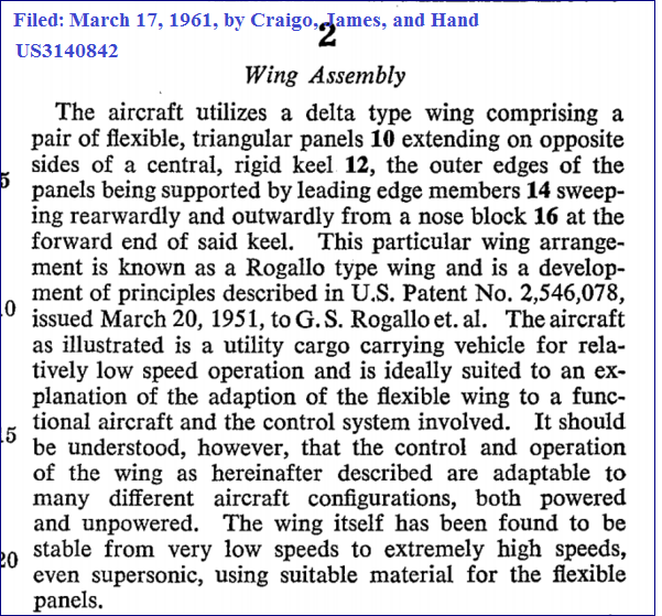

Cecil E. Craigo
Harry A. James
Leo J. Hand
These three musketeers lived in 1962 with smoothness of having accomplished filing their patent on Mar 17, 1961.
https://www.google.com/patents/US3140842 And just how much work they did toward that March 17, 1961, day in earlier months and years!
With power off: hang glider. They assigned their patent to Ryan Aeronatuical Co. The three were from San Diego, California.
I hold these three in heart as honorary members of the U.S. Hawks.
"the wing being folded when not in use to reduce the required storage space, the airframe structure being pivotally suspended from the wing and control being effected by shifting the aircraft's center of gravity relative to the wing's center of pressure."
In 1962 the patent was available to the world pending grant status which did finally occur.

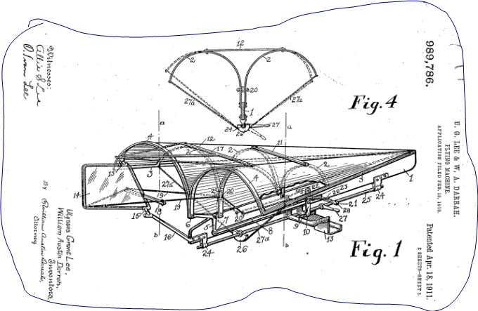

These three inventors cited http://www.google.com/patents/US989786 filed in 1910 by two others I hold as honorary members of U.S. Hawks:
Ulysses Grant Lee
William Austin Darrah
both of Brooklyn, New York, USA
I hold these two as honorary members of the U.S. Hawks.
Their flying machine was known in 1961 and 1962 by many of the people working on uses and forms of the Rogallo-wing hang glider and powered hang gliders. Lee and Darrah titled their filed 1910 patent as "Flying-Machine".
Treat yourself with appreciating every word of their patent; savor how much they realized. They seemed to have missed reflex. They were into advanced control surface. They did not want to be constrained just to bi-conical math form, but knew their control methods would serve other formats for the wing. Their drawings were just one format of their realizations; I characterize their flying machine as an anachronistic primary Rogallo glider. Easily the drawings and descriptions just misses Gertrude Rogallo and Francis Rogallo's invention of fully flexible wing; but take the Rogallo discovery and start booming and controlling ... and see some history repeating itself in the NASA circles somewhat---with the difference that Rogallo understood what Lee and Darrah did not: the potential of fully-flexible wing simply bridled to hung anchor falling or fix. All these matters were available in 1962 to many developers. But it would be at least 1908 W. Simon that kept the record for simplicity for hang glider sake with the hung pilot behind cable-stayed triangle control A-frame. All available in 1962 hang glider party.
