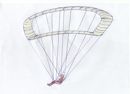

Postby ARP » Thu Feb 18, 2016 2:06 pm
Having a biplane PG configuration may help prevent sail collapse when pilot weight goes negative in turbulence. With conventional PGs the intention is that the sail does collapse preventing it overflying the pilot in a downward arc as the pilot weight normally provides the pitch stability. The problem with this idea is that it takes height to re-inflate so the PGDMC comes into play. If the biplane aerofoil were reflexed then it might prevent the downward arc and so no need for the sail to collapse.
I have a sketch for a biplane PG that would resist collapse but with a greater separation than the one Joe put in his opening post. Unfortunately attachments are not working for me so cannot add sketch?
ARP

Postby JoeF » Thu Feb 18, 2016 3:52 pm
Email sketch to me and I'll upload it to the topic, ARP.
Re: What?
Postby JoeF » Fri Feb 19, 2016 8:02 am
ARP sent this drawing of his. He had sent same drawing years ago to LIFT ezine. It is good to have it here in US Hawks Hang Gliding Association:
ARP wrote:With flapped air intakes rigidity could be maintained longer
and the box structure would help prevent asymmetric collapse in turbulence.
The pilot is supported in a parallel frame to enable weight shift control in both pitch and roll.
Inter wing interference is reduced by spacing by at least one chord length.
Tony
bipg 001sm.jpg (53.38 KiB) Viewed 13726 times
