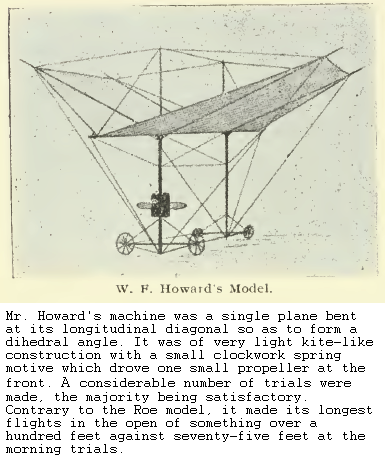

A clip from page 7 of V1N1 about a model by Howard:
