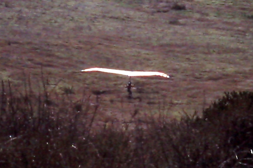

Postby Frank Colver » Wed Mar 07, 2018 11:55 pm
Speaking of seagulls I wonder how Richard miller's diffuser tip hang glider (see photo) was in yaw characteristics? The day I watched him fly it he was making straight glides from a small hill.
Diffuser tip HG - Richard Miller Nov -76.jpg (184.22 KiB) Viewed 16373 times
Re: 50' span PRANDTL 4
Postby KaiMartin » Thu Mar 08, 2018 3:21 pm
Frank Colver wrote:Speaking of seagulls I wonder how Richard miller's diffuser tip hang glider (see photo) was in yaw characteristics? The day I watched him fly it he was making straight glides from a small hill.
The tips point down like the tips of a sea gull. However, unlike the wing configuration of a sea gull, the wing as a whole is still neutral to slightly dihedral. In addition, the wing is swept back like any traditional hang glider -- again very much unlike the wings of a sea gull. Both aspects massively influence yaw and roll.
