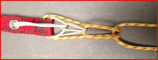

There is more than a routing problem here. Can you spot it? (I'll answer later.)
more than routing problem. do you see it--.JPG (31.14 KiB) Viewed 9973 times

Hi Bill,
That release looks to be sewn by a beginner :wtf: :crazy:
The shortest loop should be pulled through the eyelet.
Also there's no pocket to cover the end of the release pin. The release line can get wrapped under the pin and no matter how hard you pull............... :thumbdown: :x

Hi Sam,
I’ve got a sewing machine here in the Good Will pile by the front door that wouldn’t out do that sewing job in the picture.
Yes it was a misrouting of the three string release that caused the failure to release.
I haven’t yet run across the picture showing the missing pin, end, pocket, only the one side like I have pictured.

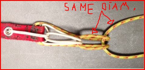

The answer to my question is that the last biggest string of the three string release is through a loop that should be even a bigger diameter string/loop.
Releasing a bigger cord than the last string of the release will further reduce the chance of a capture upon release.
This is actually why each string of the three string release has different ascending cord diameters as it gets closer to the cord to be released.
Same diam. cord is not good..JPG (31.4 KiB) Viewed 9959 times
