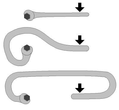

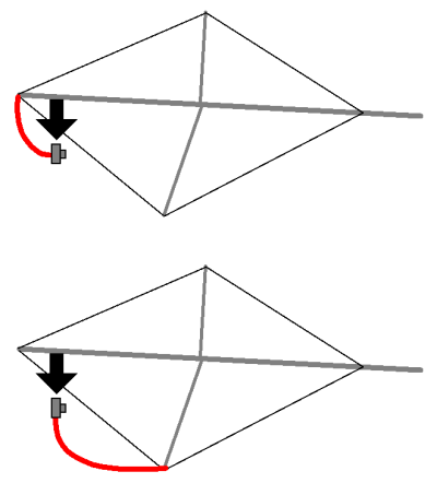

With regard to the physics of the camera mounting, I think I can help you with a diagram or two. Those will take a few minutes to work up, so I'll put them in a different post. You ask good questions, and I'm happy to spend some time trying to give you good answers.

OK, Here are some torque examples.
In this first picture, the torque applied to the bolt (through a force at the arrow) would be the same for all 3 cases (assuming rigid wrenches).
The only thing that matters with respect to the torque is the force applied and the distance from the center of rotation.
The same is true of the camera mounted in both of these cases (ignoring the mass of the mounting arm).
They would both apply the same torque to the glider (again ignoring the mass of the mounting arm). In both cases they should be compensated by a counterbalance unless it's decided that they're too small to worry about. But if it's decided that the mass of the camera mounted in the first position would require a counterbalance, then that same camera mounted in the second position would also require a counterbalance.
Additionally, since I don't know the geometry of your situation, it's important to remember that the torque on the mounting arm is also proportional to the horizontal displacement of the camera from the mounting point. So in this example, the lower mounting arm would have to be stronger than the upper arm since the camera has more horizontal displacement. Depending on the situation, that might make the nose arm light enough to compensate for its further displacement from the CG (when considering the overall torque on the glider).
Does that all make sense?

If the camera was in the same position but mounted to a beam attached to the keel at the hang point...
1. Assume the mounting hardware and beam is weightless.
2. It makes ABSOLUTELY NO DIFFERENCE what the camera's mounted to. ALL that matters is where the camera ends up.
3. Because THAT'S what / all that affects the glider's center of gravity.
(Exactly as Bob illustrated while I was working on this post.)
Assuming that Ryan's mounting is angled or curved such that the camera is CENTERED in front of the control frame, it has ZERO effect on roll but a bit on pitch - which is massively less of a problem. The glider's center of gravity has been moved a little forward and it will fly a little faster.

...I'm just saying (correctly or not) the displacement of weight by itself won't cause a roll.
Not. If you bolt the camera directly to the left side of the basetube the glider's center of gravity will offset to the left, the left sidewire will be under more tension, the left wing will be more heavily loaded, and the billow will shift to the left (but probably not enough so that a flapping batten string at the right tip won't offset the effect).
Let's say the hang strap was perfectly rigid and holding a pilot at the same position he'd be shifting his weight to initiate a roll (with his hands off the basetube).
That would do it. It would be the same as tying yourself to the downtube on that side which would be the same as pulling yourself to that side using the basetube (or, if you must, the downtube).
I can see this would put some torque on the keel...
Don't think torque on the keel. Think center of gravity of the pilot/glider system.
