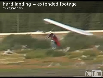

TadEareckson wrote:Yeah. His hands are on the basetube all the way down to the surface and stay there while he continues finalling uphill and only come off to go to the downtubes six seconds prior to a touchdown preceded by a rather alarming and unnecessary flare.
So doesn't this support - rather than contradict - what the low time pilots are seeing Tad write?
Now kids, ask yourselves how much worse this guy's landing:
would've been if he had stayed fully prone and zipped up in his pod with both hands on the basetube and the bar held back for most of that clip.
OK let us play it out.
Dude is prone. Makes the same mistakes as the upright pilot. Piles in head first.
I would much rather have some downtubes to hide behind rather than lead with my head.

Postby miguel » Tue Nov 15, 2011 4:58 pm
Tad
The fellow did not fly a good approach. He was too slow and did not realize it. He would have done the same thing prone. It is not hard to pull in and make a good approach when upright.
Seems as though, you pick out a video that appears to illustrate whatever it is that you are railing about. Then you 'create' pilot intent and present it as fact to back the railing up.
Still would rather hide behind the tubes than lead with my head.

Postby Bob Kuczewski » Tue Nov 15, 2011 6:36 pm
miguel wrote:The fellow did not fly a good approach. He was too slow and did not realize it. He would have done the same thing prone. It is not hard to pull in and make a good approach when upright.
I believe you're correct on all counts.
Additionally, if you look closely, I believe you'll see that he had his right hand on the base tube. This is a common configuration designed to retain base-tube pitch control.
So I think it's an error to attribute this poor landing to being upright and somehow not having enough pitch authority because his hands were on the downtubes (because one of his hands was on the base tube!!). Instead, I think he simply did not fly a good approach as Miguel has said.

Postby TadEareckson » Wed Nov 16, 2011 9:34 am
Which is why I said:
He was virtually fully upright with his left hand about a third the way up the downtube...
It doesn't. If a hand is on a downtube it greatly limits the range the pilot can pull in. That's why:
Jim Rooney - 2011/06/12
Most common HG injury... spiral fracture of the humerus.
And, now that I think of it, THAT'S what limits your pitch/speed range - not basetube contact. You can pivot a little if necessary to move the bar back.
If he pulls in as much as possible with both hands he'll do a wingover.
The advantage to having one up and one down is that the pilot can almost instantly shift back to the basetube should that become necessary and it greatly facilitates a quick transition to upright.
So I think it's an error to attribute this poor landing to being upright and somehow not having enough pitch authority because his hands were on the downtubes...
I don't.
...(because one of his hands was on the base tube!!).
Irrelevant.
And that's FAR from a valid assumption - let alone statement.
It's easier and more comfortable to fly fast prone than it is upright therefore - while it may be quite POSSIBLE for people to maintain ADEQUATE speed through approach and landing in ALMOST all circumstances upright - you should expect to see more stalls from uprighters than proners.
And I'd predict that if I hopped in my time machine and beamed up to launch, that guy would've had an uneventful landing if I had said nothing more than, "I've got fifty bucks that say you can't land that thing on the wheels."
Also note that, likewise, since it's easier and more comfortable to unhook from the glider to get your cell phone from the stump in the setup area than it is to climb out of and back into your harness, when you're dealing with actual humans you WILL predispose a lot of them to failure to hook in disasters by trying to impose the Aussie Method on everyone.
