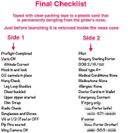

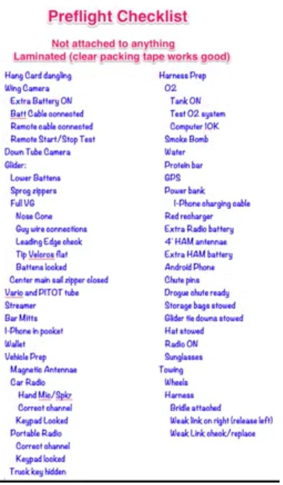

Greg Porter in 2013. Challenge with false positive FTHI
Postby JoeF » Mon Jun 08, 2015 6:10 pm
