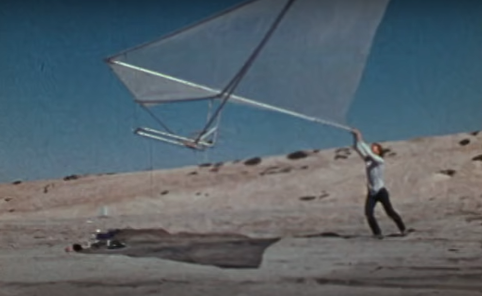

Postby Craig Muhonen » Mon Oct 11, 2021 9:53 am
David Cronk is testing his glider design, training his mind, and pretending to be a "tailfeather". HA
Rick Masters wrote:"Clear" is a command used by the pilot at the moment of take off.
It is a demand that assistants get out of the way and allow the glider to move forward under the sole control of the pilot.
