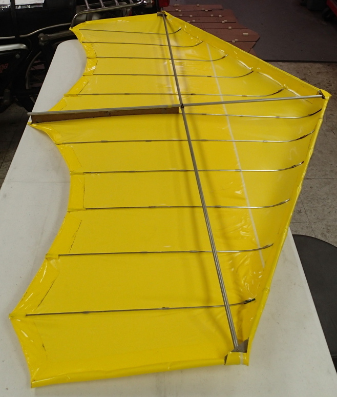

Here's a photo of the underside of the covered 1/5 scale model, before flight testing was done.
Covered model underside.JPG (206.59 KiB) Viewed 6575 times

By TjW
- Mon Dec 17, 2018 1:26 pm
Is there a reason why the crossbar runs all the way to the tip?
Bending loads out there are relatively small. A shorter crossbar would weigh less and be less likely to fail by buckling.
By USHPA7
- Mon Dec 17, 2018 2:07 pm
Yes, it is to support the loads of the highly truncated tips. Also remember it is not as long as it would be if it was positioned the same way on a standard glider because the span is shorter. The diagonal brace from the center of the tips will help support the LE some (not on model, see drawing photo).
I recognize that the LE bending loads are inward across the full length of the tubing which is different than other HG's. But the tubes are only 15 1/2 feet long which helps. I'm still deciding on LE tube diameter and I'm going to do some load testing after I buy the 7075 tubing from Wills.
Thank you for your input, I welcome any ideas and suggestions. At this point in time I'm probably fairly well set on this design as I want to start building soon. But I envision that after the 1st glider, there will be "upgrades" in design and construction based on problem areas as discovered. Even if I never build a 2'nd one, I will publicly identify the problems that I see as needing to be corrected. One problem could very well turn out to be structural strength, which is why this prototype will see a lot of Dockweiler Beach sand. So many homebuilts and new designs saw their first flights there that will I feel honored to add to the list. This year the test flights of my new swing seat harness saw 1'st air there and back in '72 my "Colver Skysail" rigid wing.
ONWARD WITH THE DOCKWEILER TRADITION! :)

So, this design is pure weight-shift for roll control. It appears as though there is absolutely no geometry change as compared to a typical hang glider (floating cross-bar). I'll guesstimate that this will create a positive feedback loop of sorts in most conditions, making roll control more difficult to manage.
Typical hang gliders have roll control primarily with geometry change rather than pure weight-shift. If the cross-bar did not float, there could not be geometry change in the sail, and roll control would be very hard to initialize with weight displacement, but also would be nearly impossible to correct for external rolling forces in an expedient manner.
Because of the shorter span, pure weight-shift may initiate roll more quickly, but still you will have the problem of correcting for external rolling forces.
I hope you have remote means of testing your design for roll control.

DMarley,
I realize it doesn't show in the drawing, or is incorporated on the model, but the design has both a floating cross spar and a deep keel pocket. So, it should turn just fine with weight shift. I do appreciate your concern since you couldn't have known about the floating cross spar and deep sail pocket, since I haven't talked about actual mechanical details of the glider.
One of the things I have been giving some thought to is how to support the reflex at the "swallow tail" and still allow the sail to shift side to side. I'm thinking of a vertical short post that supports the sail batten TE upward but can pivot side to side. I think tying it up to the rear kingpost cable would limit its side to side movement too much since the cable would be very close at that point.
The cross spar will probably use a Wills ball joint and typical haul back cable. A problem I'm facing is that the cross spar will be behind the king post and will have to pass it when folding. A suggestion I was given, and I think may be the solution, is to detach the bottom of the post, when folding the glider, instead of merely folding it down.
I think the fact that the floating cross spar goes all the way to the tips may actually enhance the effect of weight shift on the sail billow.
Lots of mechanical details to be worked out as the project progresses.

Bob Kuczewski on Dec 23, 2018 wrote:First, and most importantly, I think it's great that people like Frank keep thinking "out of the box" to improve the sport. The freedom to explore outside the box in glider design is part of our American aviation heritage.
Having said that, I've had two concerns with the design presented here. I've kept them to myself largely because I didn't want to give the impression that they might be based on politics. But since I mentioned them to Mike Grisham on the phone today, I'd like to share them here.
My first concern is for the structural integrity of the outboard tip struts. They are relatively long and are responsible for holding tension on a good percentage of the deep chord section. I think this will be problematic both in maintaining tension and in resisting torque.
My second concern is glide performance. Glide performance is obviously a secondary concern for this glider. But if the performance isn't sufficient to get off the ground in moderate winds at sites like Dockweiler, then that will largely undermine its utility as a training glider.
I wouldn't place any bets on my concerns and I hope they might inspire appropriate investigations and/or modifications to dismiss them.
Red on Dec 24, 2018 wrote:
Bob Kuczewski wrote:My first concern is for the structural integrity of the outboard tip struts. They are relatively long and are responsible for holding tension on a good percentage of the deep chord section. I think this will be problematic both in maintaining tension and in resisting torque.
Frank,
Sail tension will mostly be supported at the crossbar ends, not at the wingtips. The rearward part of the leading edge and the ribs will only carry the span-wise loads outside of a line drawn between the sail tail and the crossbar ends. These parts may need stiffening, shortening, a diagonal brace, or even a sprog to help carry that load, but it probably won't need much, if anything, there. For clarity, the Comets used a "diagonal brace" to carry the span-wise loads at the wingtip, in the form of a strong straight rib inside the sail, pivoting at the leading edge spar. That pivoting may be limited if desired, by using a bracket instead of a ball-in-socket.
Wingtips do not generate much lift with HGs. For a trainer, they may be more handicap than help, making the wing more unwieldy to the beginner pilot. Luff lines can replace the pitch stability "lost" with the missing long wingtips.
I like this design for a lot of reasons now, and I do not doubt that future development will improve on the prototype. Lead ON !! 8-)
There is a 45* diagonal brace located at 50% of the tip chord to transfer tip inward load to the LE where the sail is pulling inward in nearly 90* direction to the tip. Basically using sail load at one place to support sail load at another place. The forces will not be equal but every little bit of support helps. I'm not sure that everyone has noticed that diagonal tip brace on the drawings. I didn't put it on the model because the model is built with excessive strength.
Glide ratio: The glide ratio will definitely be better than the rogallo and many of them flew from Dockweiler in the old days. The model had a better than expected L/D but there were no flying wires, a control bar, king post or pilot adding drag. If the model had a poor glide without those things i probably would have stopped right there. The model looked especially good when it entered ground effect on the beach but with the low aspect ratio there won't be much of that with the full scale version.
Only Andy, Josh, and I have seen the model fly after I got it trimmed with enough reflex and a far enough forward CG (30.5% of MAC) plus firmly attaching the sail to the battens (it pulled loose the 1st time out). I will be increasing the tip positive angle to get enough reflex on the full scale version. It was only +5% on the model and I had to bend the fifth batten to increase it. Thinking of +15* on the big one but also thinking of having several angles (20* & 25*) that can be changed without modification of the structure. I would like the Cg to be about 25% of MAC for good pitch damping so a student wouldn't feel like it was too sensitive to fore and aft weight shift. This glider isn't going to be making any speed runs!
Thanks for the always welcome input guys,

Red wrote:Sail tension will mostly be supported at the crossbar ends, not at the wingtips.
Take another look at the drawing. The crossbar ends ARE at the wingtips. The outboard rails will need to maintain similar tension as the crossbar or the sail will have a "gutter" running from the aft keel point to each tip (where the leading edge meets the crossbar).
Red wrote:Wingtips do not generate much lift with HGs.
They may not generate much lift themselves, but their presence extends the spanwise distance that the high pressure under-surface air must travel to reach the lower pressure upper-surface regions. Think about what winglets do. Winglets don't generate much lift, but they improve the performance of the rest of the wing.
The full size version (if it's ever built) will be the final arbiter.
