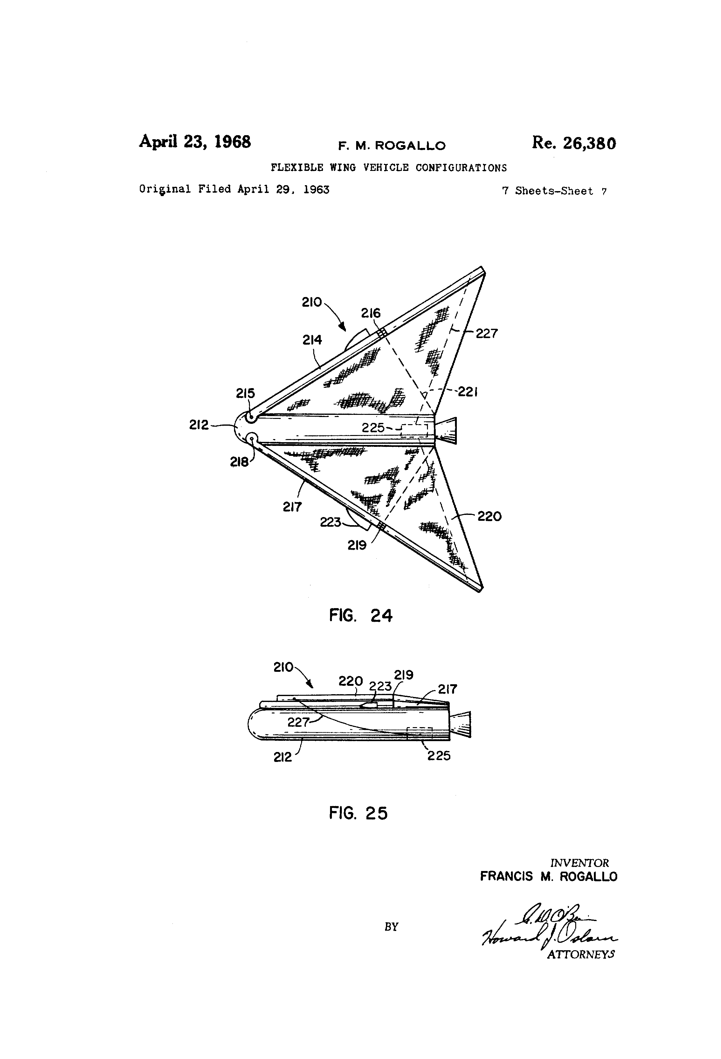

Postby Rick Masters » Thu Apr 26, 2018 2:02 pm
use ctl sft - to view
Francis Rogallo's rocket-powered hang glider.     :twisted:
(Well, maybe not actually a hang glider...)
Full-luff dive, eat my dust!
https://patents.google.com/patent/USRE26380
Postby wingspan33 » Thu Apr 26, 2018 5:06 pm
A rocket powered hang glider?!!! :shock: :shock: :shock:
Talk about dangerous sports! :wtf: But in this case probably meant for military use. :thumbup:
