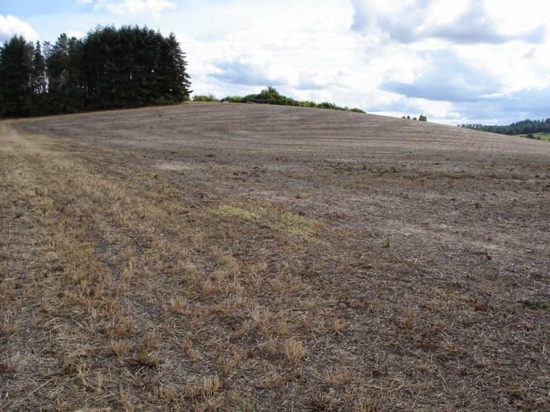

site: across the street hill
It took me most of this spring to find a hill suitable for learning to fly the glider I inherited last fall “Dr. Darrell” at Funston. Got permission to fly the slope across the road from my house which turned out to be an OK shakedown slope. I'm guessing about a 7:1 slope that levels out prior to the pond fence so that in the event I get airborne, I think I can land before that. I made several runs when a 3-4mph breeze would cycle in from the right direction. The longest was about 20 yds or more. I had all I could do to balance the wing and try to keep it level as I ran trying to manage the right angle of attack. Mostly, I just ended up stalling it early in the run because I was afraid to have it get going faster than I could pull it to a stop. I spent a good part of the time fussing with the seat harness. The seat was too wide to fit between the cage tubes and I finally removed the yellow plastic seat using a hacksaw and just used the webbing for a seat. I managed one run in a decent breeze where I pitched up sharply and tail slid back onto the TE. Nothing damaged. As it got toward 6PM, the good cycles went away and were replaced with N and NW cross so I bagged it and went home.
I got some runs in at this hill but the conditions were so restricted I never really had more than one session where the breeze was enough to help get the glider get flying itself let alone, launch me in it. After 3 days here (sessions #1-3) and not really doing much beyond running the glider down the hill I started looking for a better site.

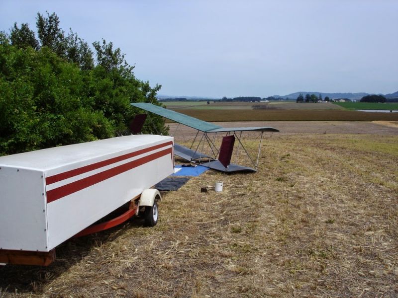

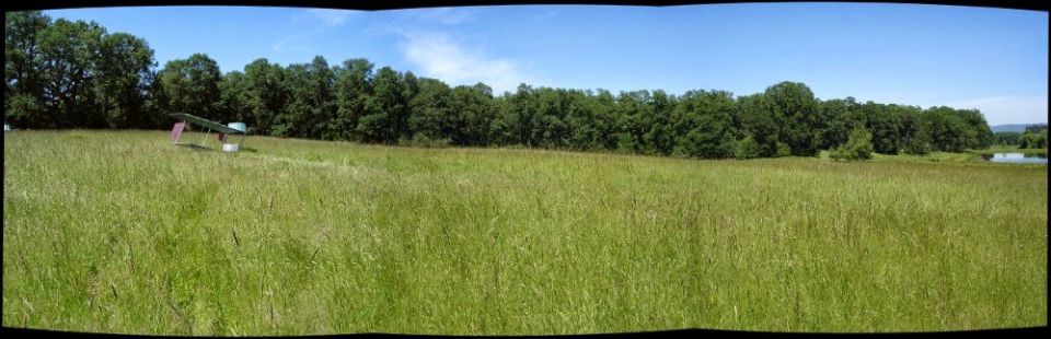

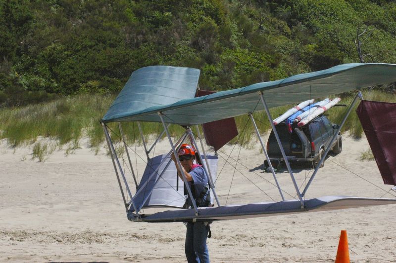

The next one I found was almost exactly 10 miles from the house and had a nice short little road right to launch. Here's a shot of the set up area and launch. Notice the launchable directions this site offers as well as the clean, unobstructed fields way out in front. The top was also flanked by trees on both east and west sides offering a nice wind shadow for setup. The short little road right out to the setup area and launch made this a real find! If it were only another 100ft high.....

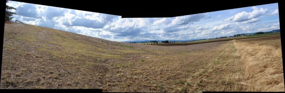

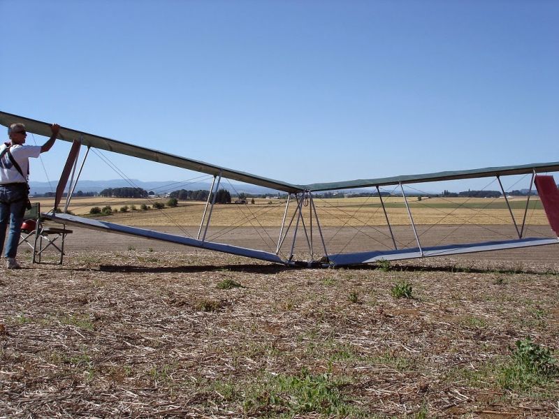

This next shot is looking back up to the top of the hill and if you look close, you can see the Easy parked in the middle of the due north launch section.
This shows a bit more perspective on the hill(shot from the bottom of the east launch side with the Easy parked at launch on the N through E launch section on top.

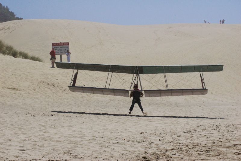

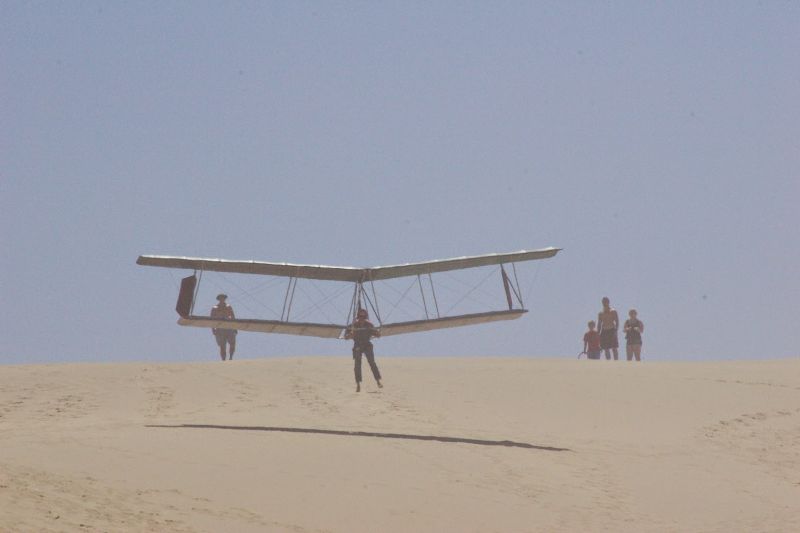

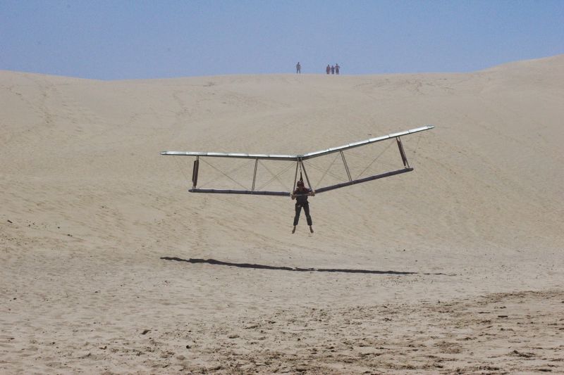

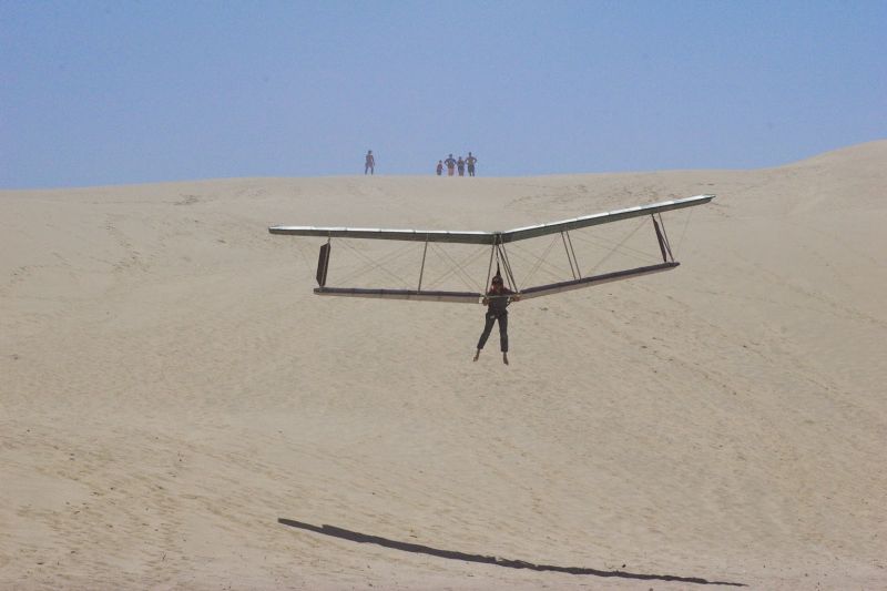

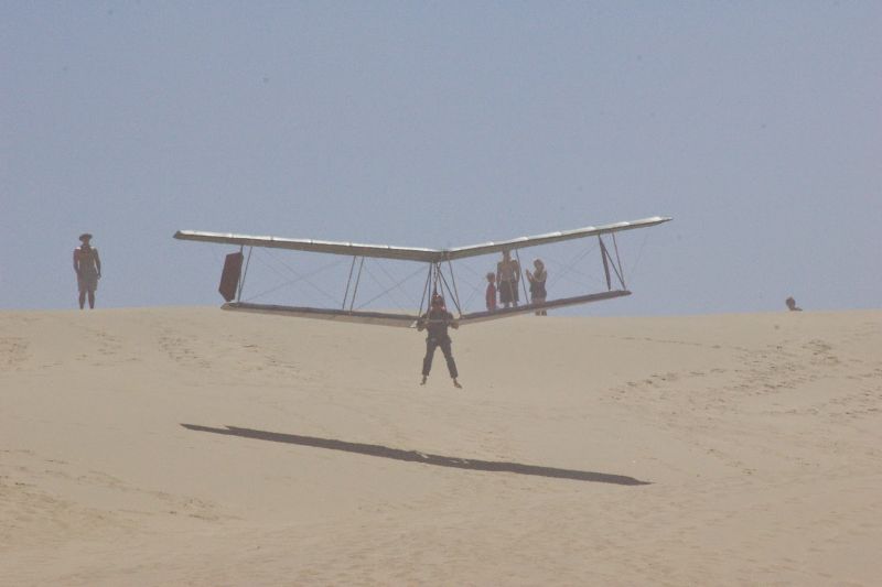

The video link above was from a clip taken by one of the onlookers that day. The still photos that follow were taken of the second or third flight.
Tim Weaver, a hang pilot I met at the beach sent a CD of still shots he took of those first flights I made.
This shot shows a little of the shoulder straps that allow me to take all the weight of the glider onto my shoulders which frees both hands to either control the rudders, balance the wings level using body torque or keep the nose down when launching.
Here I am ready to start my launch and you can see that I've got both hands up on the diagonals to steady the wings and keep them level. As soon as I'm ready to go, I dropped both hands onto the hang tubes well toward the leading edge to keep the nose from coming up which it wants to do (and it will stall if you let this happen with no downward pressure).
I have just left the ground in this shot and where you see me hanging is about where I set the hang strap length. My forearms are just about parallel to the hang tubes which may seem high but that's where I felt I had the most control.
Notice I've deployed the right rudder, probably to counter a heading just after launch that was taking me too far off the wind to the left just after launching.
Here you see the result of that rudder control move. The rudders are really effective, even at low air speeds.
In this shot I've leveled out again and am trying to manage a smooth turn toward a final glide path to the beach.
Sweet flying glider! Starting to think about a gradient in the breeze as I glide out of the gentle lift band against the dune.
Gliding on in I get ready to run it on and stall the root. The glider was amazingly easy to stop. The tips kept flying as I stalled the root and had no problem catching the glider as I touched down.

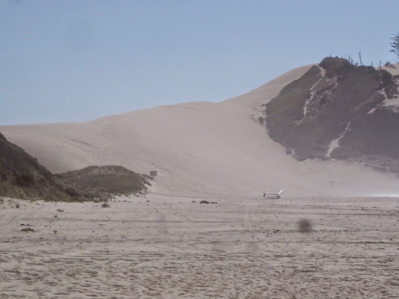

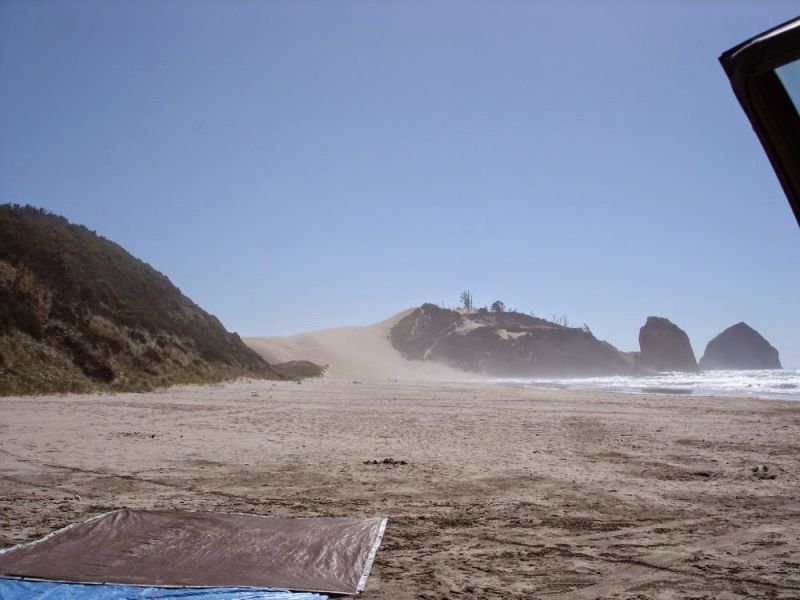

The top photo was taken right from the car where I unloaded and set up. You can hardly make out the Easy parked against a camp stool at the base of the dune.
The bottom photo was just a telephoto of the same shot where you can actually see the glider.
