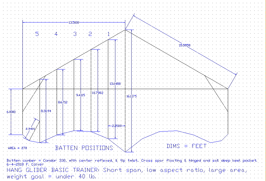

The design is a low aspect ratio, short span, high lift (high camber), large area glider. There is tip twist for pitch stability reflexing and to stall the tips last and a "swallow tail" center that is also reflexed. It should be slow flying, with soft stall, stable but very responsive to weight shift control of pitch and roll. Some people have expressed concern about tip weight slowing roll response, because of the 6 feet long truncated tips. I point out that the 13.5 feet moment is shorter than other gliders of similar area, which will help. The complete glider weight goal is to be under 40 lbs.
The final design comes out at 27 feet span and approximately 280 sq ft. The weight will have to wait to be seen. I’ll use the lighter sail cloth also used on the Condor 330 and tubing sizes will be less than what would be used on a general purpose glider. The airfoil is the Condor 330 airfoil, and I will be using some of the actual 330 curved battens.
One area this glider might find its use beyond basic training is in soaring low beach front dunes “dune grooming”. Its short span, large area could make for good close in ridge soaring, keeping more of the glider in the better lift zone and the turns would be tighter.
All of my drawings are in AutoCAD, so I can’t attach them but I have attached a jpeg image of one drawing. I’ve also attached a photo of the model glider rising in slope lift above a hand launch.
I’m also looking for a wrecked salvage glider, preferably a WW Falcon or Alpha that I could cannibalize for fittings. Since I will not be selling this prototype glider I don’t need new fittings. I’ll be using all new tubing so I don’t care what condition the tubes are in or the sail. Please let me know if you know of one that’s available.

My intent is to build a glider so easy to ground handle with good roll control response in flight and good pitch damping + slow flight and landing, that we almost return to the days of the rogallo but without the bad characteristics of that flat flex wing design. Many people taught themselves or took lessons with gliders that were easy to ground handle and fly but lacked the good parts of the fixed camber airfoil (battens) and reflex of today's flex wings. This is strictly a "training hill" or "dune grooming soaring" glider.
Shooting for a all up weight of less than 40 lbs using 1-1/2" cable braced tubing (similar to the WW SST) and thin light sail material.
I'm assuming a low sink rate with a glide ratio somewhere between that of the old standard rogallo and today's single surface flex wings. Maybe the L/D will be in the neighborhood of a large paraglider.
My first thoughts on this design is shown below. Please carefully read all of the text on the drawing before commenting.

Yeah, that's the general idea, Bob. That's why the old standard rogallo was so much easier to ground handle. But without a permanent defined airfoil it was harder to launch. You had to be more careful of angle of attack as you started running.
Higher aspect ratio & span is needed when we want a good L/D but not necessary for a low sink rate. That's where large area and high camber airfoil can get you. I plan to copy the Condor 330 airfoil in the front.
Note the return to the WW "swallow tail" for reflexing the center batton of the sail and a generous amount of movement of the keel pocket in roll control.
If I decide to go further along these lines I'll build a 1/5 scale free flight model to test, like I did with my Skysail in '71.
If I were to build the full scale HG I could probably purchase a lot of the hardware from Wills Wing. Like for the three corners that are 120 deg I could use WW Falcon or Alpha nose plates, etc.
From WW archives I have the "wingpost" LE cable bracing drawings which I could duplicate if they turn out to be what I need there. As it is presently shown, I would need to brace the LE's on the inside, under the sail instead of out in front because the cross spar goes all the way out to the LE tip corner. The pull on the sail would be trying to bend the LE inward in the center instead of tip flexing.
A lot of mechanical and structural design yet to be done before a simple outline becomes a buildable (& foldable) glider.
Thanks for your comments, Bob. :thumbup:

Using a geometric approach shown to me by Mike Meier at WW I have approximated the CG of my basic trainer glider design. There will be more error in my calculations because my sail is not cut in the straight line at the TE. To be more accurate I would have to come up with the straight line equivalent of the area back there.Mike showed me how to find the Mean Aerodynamic Chord and then set the CG at 25% of that chord line. This should get me into the "ballpark" for the initial tests so that the CG is not way off to begin with.
I'm getting close to building the 1/5 scale flying model.

reluctantsparrow wrote:I see you have increased the truncated portion compared to the initial drawing sent to me via email Frank. As a matter of observation, I also see the truncated portion, the leading edge, and the crossbar all share a common junction point. Also, the crossbar is drawn straight across.
I have two questions so far.
1. Is the crossbar going to be divided and floating like current hang gliders?....and
2. How are you planning to join the crossbar, leading edge, and truncated portion? I can imagine a regular type junction for the L.E. and crossbar but with the junction plate extended on the truncation side to provide a "pivoting point" for the truncation....so all three tubes are actually joined by a single plate?
3. If the crossbar is going to be floating, and the truncated portion is also going to be foldable, I see a fairly short package if this is the case. If the truncations could fold to lie parallel with the L.E. the disassembled glider will not be much longer than the keel itself....and only 40 pounds?
Yes please!
The shape is almost identical to one of my favorite paper airplane designs.
BTW....to everyone else...
I had the privilege of being at Wills Wing as Frank was sharing his ideas with Mike Mier...Kinda like a fly on the wall....
I was actually pretty surprised as Frank suggested smaller diameter tubes like we used to use cable braced via deflexors and Mike didn't flinch an inch....Mike said, "sure, why not"?
I remember the tests done on the wills wing SST....they hung six pilots from that cable braced glider made from 1 1/2" by .049 tubing and the glider never broke even though the leading edges were horribly deformed....that old glider was super light and strong as a bull.
I love it Frank.
Although no design of any aircraft can be totally idiot proof.....this design is going to come awfully close.
reluctantsparrow wrote:I am sure you have your own plan for holding the truncations in the "flying" configuration....to hold tension in the trailing edge and to determine washout, etc. etc......
Since all three tubes are coming together at one point (the L.E., the truncation, and the crossbar)....I can see multiple possibilities....
Any of the ends of those three tubes.....the rear of the L.E., the front of the Truncation tube, or the outside ends of the Crossbar, can be extended beyond the junction of all three to provide a point of attachment
Thanks for your comments, Jim.
I think I mentioned somewhere that the cross spar would be floating and foldable but maybe it was just in my head. I was thinking I could buy the ball and socket joint from WW and modify it if it didn't fit the tubing I use.
As far as folding goes I just have a general idea floating around in my head. The truncated tips would have the diagonal braces removed and then folded inward along the LE's. I'm hoping that with a "noseplate" type of junction at the place where the tips, cross spar, & LE come together I can get a configuration where all of those can fold together. This is something I can physically model to try different things if I can't work it out in AutoCAD. The "fly in the ointment" will be how much room the sail requires as it bunches up against the tubing as it is folded.
For holding the upward twist in the tips I'm counting on cable from the king post. The short span will give me a greater angle of the support cables which will help and I may also have to go with a fairly tall king post. I'll probably need cable to the tip ends from the base tube also. That diagonal brace from the tip centers to the LE's is going to be a very important component that the support cables work with.
There will be three main design stages:
1) Test the flight performance in a 1/5 scale model. Make any changes needed from results there.
2) Decide on tubing sizes and cable bracing methods, where used.
At this point I will need to evaluate the tubing size/weights for "complexity vs benefit". It may be that with the short span that 1-1/2" x .049 6061 cable braced may not be much of an advantage over 2" x .032 7075 not cable braced. BobK suggested this evaluation. Although I have an inclination to trust more the structural integrity of the cable braced approach.
3) Design detailed junctions of folding components and other hardware components. Probably going to be some physical full scale modeling done here.
Next will be the construction of the full scale airframe and getting battens made by WW. At this point it won't be complete with control bar or king post. Just a lay on the floor airframe. Now beg, conjol, plead, with Steve at WW to make me a sail for it. Actually before the battens ar made I hope to get some input from him on the exact cut of the trailing edge curves for distribution of loading and airflow without flapping edges.
I envision the sail tension along the LE's to be a grommet with a line extending out to the corners with the tips to pull tension outward. The ends of the tips could be done the way it is done on current glider wingtips.
Jim, I may follow your lead and offer to buy a block of time from Wills Wing for getting more input from Steve. If they would sell me several hours for an "advice and sail design details conversation" it would be money well spent. Remember at this point I have the basic airframe done and I will have my batten curves design approximated.
To be continued.............

Red wrote:Hey gang,
Not sure what the plan is, to attach the truncated tips to the main wing spars. In the true spirit of HG "R & D" (as in, Rip-off & Duplicate), I would suggest using bent joiner tubes (rather than any heavy bolted structure), similar to what was used on the ASG-21 Albatross.
Those joiner tubes were bolted to the leading edge, but I re-made mine with three equally spaced Stainless Steel 0.25" blind rivets (instead of bolts), to save weight. Together with other crafty hardware mods there, I removed (IIRC) about 60% of the tip assembly weight on the ASG-21, and I was able to demonstrate to Tom Price that my Albatross had about the same 45/45/45 roll rate as a WW Raven. He said if he had not seen it, he would not have believed that.
Now I recall that the ASG-21 joiner tubes were bent rather sharply, with some minor kinking in the middle of the bend. I believe we can make those bends better today, using a slightly larger radius, and bending the joiner tubes before applying the T-6 tempering process.
Hope that helps a bit.
Thanks for the suggestion Red.
I was also thinking of using the "joiner tube" method you suggest but since I will be fabricating this glider in my shop, using the machine tools I have, I was going with bolted plates because it would be easy for me to fab those fixtures. However, I definitely agree that bent tubes would be better from a weight standpoint and avoid sharp places where someone bumping into the tips would get cut.
However, the use of plates and bolts also facilitates my folding of the tip tubes in along the LE after removing the diag brace tubes. Additionally, if I want to adjust the horiz tip angle slightly greater or lesser than 120*, to change the tip sail tension, I can do that by changing the length of the diag braces when using plates instead of a fixed bent tube.
If someone were to put this "one off" experimental glider into production, then the joiner tubes could be the way to go, as you suggest. :thumbup:
