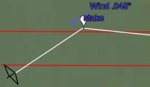

Postby Bill Cummings » Fri Apr 24, 2020 3:52 pm
RGSA Hawks and Drivers,
A while back I had someone comment on one of my YouTube videos that the crosswind stake I was using for take off was not that easy to see.
I'll put the link where I had the comment but like was said it doesn't show much even though it's being used for static car towing.
(Come back to the link after reading this post if you like.)
https://www.youtube.com/watch?v=E6IFmX3t2vg
In my drawing below you will see an east/west tow road that has a left crosswind. This is when I pound in a Crosswind Stake to allow
the running take off into the wind. As I leave the ground with the hang glider the towline will lift up and come clear of the crosswind
stake.

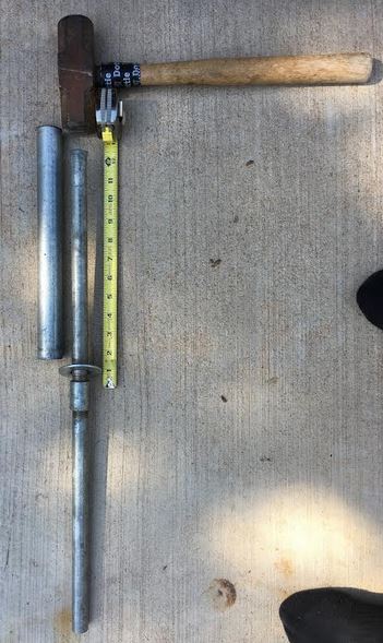

To make the stake I had the hardware store put threads on each end of a two foot long pipe that was 1/2" diameter.
Next I cut the pipe in half.
Next I threaded the two ends into a pipe coupling. The next step was to place a big enough washer to fit onto the pipe but stop
at the coupling. I would pound the stake into the ground so that the coupling was in the ground with only the end of the coupling
flush with the surface. The big washer was resting on the ground and the end of the coupling.
Next a bigger pipe was placed over the one foot pipe half that was standing vertically above the ground.

Postby Bob Kuczewski » Sat Apr 25, 2020 12:42 am
That's pretty clever Bill. When I first saw your diagram, I was concerned about the friction of the rope around the stake. Then I looked closer and saw your vertical roller bearing.
Brilliant. :idea:
I do have one question. When the rope rolls off the stake, do you notice the transition in either tension or direction?
Re: Static towing ground based.
Postby Bill Cummings » Sat Apr 25, 2020 3:36 pm
Bob Kuczewski wrote:That's pretty clever Bill. When I first saw your diagram, I was concerned about the friction of the rope around the stake. Then I looked closer and saw your vertical roller bearing.
Brilliant. :idea:
Yes to both questions Bob.

There have been times when I used a Crosswind Stake that had the towline doing a 90° angle at the stake.
For pilots starting out using a Crosswind Stake it would be prudent learning with only slight cross winds.
A tow pilot should already know that while towing the best place to be is downwind of the tow vehicle in the sweet spot.
The longer the towline the broader is the sweet spot that the pilot can safely operate (left and right) of the tow vehicle.
Shorter towlines also narrow the sweet spot.
Higher towline tension narrows the sweet spot. The lower the towline tension the sweet spot is wider left and right.
Using the Crosswind Stake narrows the sweet spot that is to the right of the stake in the picture shown above.
In this example the pilot should release if his glider is moving toward the right of the stake.
If the glider is heading to the right of the stake a lockout can occur quickly.
The pilot is in good shape if the glider is moving toward the stake or even to the left side of the stake.
As the glider lifts the towline above the stake the tension will drop a lot and now you are no longer in the sweet spot of the
Crosswind Stake but actually to the left side of the sweet spot of the tow vehicle. During this moment of reduced tension
the pilot needs to point the glider toward the tow vehicle and allow the cross wind to drift the glider to the down wind side of
the tow road. The sweet spot is not centered over the road but down wind of the road and the tow vehicle.
The pilot will have to radio to the tow vehicle to speed up since the glider is no longer headed straight into the wind
after the towline clears the Crosswind Stake. Also once the towline clears the stake the sweet spot of the tow operation
becomes instantly larger and even more so due to the drop in towline tension.
