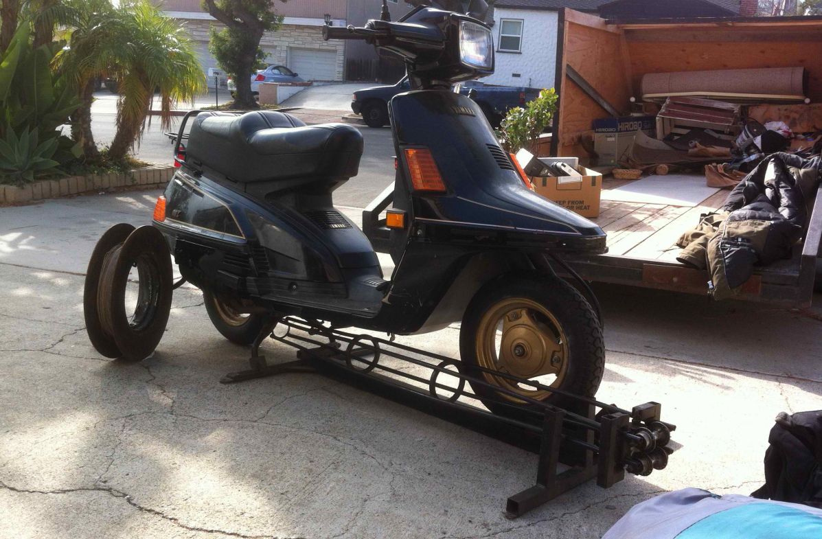

I'm sorry I don't have a lot of towing experience, but I was just browsing the Crestline forum (http://www.crestlinesoaring.org/node/581) when I found a fellow selling a scooter tow rig:
I have a feeling that's not what you're looking for, but I thought I'd post it anyway in case anyone is interested in setting up a scooter tow.
Here are some descriptions from the fellow selling it:
STATIONARY SCOOTER TOW RIG $600 O.B.O.Must sell now
Submitted by Rando on Fri, 01/17/2014 - 10:53
Forums:
Marketplace
Designed and built by Brian Dahl.
Includes 1984 street legal Yamaha 180Z scooter.
4,000 foot Spectra line on drum that replaces rear wheel via 3 lugnuts.
Welded steel line guide.
Location: Dana Point, Ca.
Call Randy
714-235-7446
Sorry, I have no pics.
It's 3 separate pieces: The scooter. The line guide. The Spectra reel. No trailer.
The scooter is just a bit over six feet and fits in the back of even a small pickup at a diagonal
The line guide stakes to the ground in front of the scooter, and the scooter needs to be tied to something so it doesn't get pulled towards the glider.
I am moving and don't have any time to stop to do anything else, so no demo day. Sorry again.
If anyone knows how to get ahold of Brian Dahl (designer/builder) or Monte Bell,(the guy I bought it from) you could find out more than I know about it. I used it only once. 2 tows, worked well.
Monte said he would buy it back from me if I ever wanted to get rid of it, but I don't know where he is.
I paid $1500 for it. The concensus was that it was a really good deal.
Also, to be honest, I talked to someone about the reel size and he felt that it probably doesn't really have 4k feet of spectra line.like I was told
Even if that's true, it's still a screaming deal.
The glass is out of the left rear view mirror, and the gas cap is missing, and it needs a new battery. It was like that when I bought it.
I just did a quick search to see if I could find any pics. Didn't find any.
I found a few referrences. One of them mentioned a pulley out some distance from the scooter.
That is not the case with this one. The line guide is immediately in front of the scooter and the stakes need to be put in at an angle so it does't lift when the line angle gets steep.
Hope that helps a bit.

Anyway, I started it up today. Had a hard time. Googled it. Turned out it was because the side kickstand had to be up, and the brake had to be pressed to start. I totally forgot that. Ha.
Started right up. Runs GOOD. Carb float stuck . Tapped on it with a hammer handle and it mostly stopped the overflow. However, it still drips 2 drops per second while running (but doesn't flood out). Stops dripping when not running. May get better, may not. It may need to be taken apart to clean the needle.
I don't have time to do that, Will take best offer (If there is one).
This thing really is slick. I would REALLY hate to throw it away(see below).The Variator transmission is amazingly powerful, and the inginuity of the way the feed comes out the front without interferrence is way cool. I just wish that I didn't have to get rid of it (even though I haven't used it forever) go figure.
BTW: I talked to Brian Dahl. He said that he didn't make this one, and that he had always tried to figure out how to do the "out the front" feed efficiently. Brian said that Marcello (DeBarros: AKA Atmosphere PG) had a couple of his builds at one time, and that they had discussed modifiing one, but didn't know of any such critter in existence.
