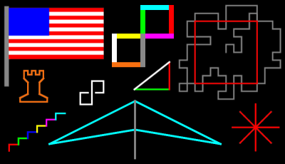

Learn to Program: Etch1 Introduction
The "Etch1" computer has a fairly simple instruction set where each instruction is just a single character. An Etch1 computer program is just a series of these single character instructions that tell the computer what to do. There are a total of 28 different instructions, but most programs will rely most heavily on only 4 (U, D, R, L). These 4 instructions (U, D, R, L) stand for Up, Down, Right, and Left. Here is an example program that draws a simple diagram using only those 4 instructions (You can ignore the spaces. They are just helping to show the structure of this program.):
      UUU RRR DDD LLL LLL DDD RRR UUU
This program begins with a series of three "Up" instructions (UUU) which draw a small vertical line starting at the center and moving upward (all "Etch1" programs start at the center of the drawing). The next three instructions are all "Right" instructions (RRR) which will draw a short line to the right. Similarly, the "D" instructions draw down, and the "L" instructions draw left.
Now look at that program, and try to visualize what those instructions will draw. Get out a pen and paper and try to draw for yourself what that computer program tells you to draw. When you're ready, click this first button below to see how the "Etch1" computer follows those same instructions.
Your browser does not support HTML5 canvas
Did it match what you expected? If not, please take some time to understand why the program drew what it drew. Maybe use pen and paper to try to follow the instructions again now that you know what it should be drawing.
Let's try another one. This one is a bit longer, and it might be helpful for you to use lined paper or even graph paper for this drawing. Here's the computer program:
      LLDDRRRRDLLLLLUUUUUUURRRRRDLLLLDDRRRDL
When you think you've got it, go ahead and press the button below to see if your drawing matches the computer output.
How did you do this time? Again, if your drawing didn't match, be sure to understand why and draw it again until it makes sense.
There's a lot more to this simple drawing "language" than that. For example, here's a simple hang glider outline drawn in "Etch1":
That glider was drawn with these instructions:
      WW3SSMUUKRRRRRRDDDkKLLLLLLUkKLLLLLLDkKRRRRRRUUUkK9DDDDk
For more details see the full set of instructions below or read the BBCode tutorial for "Etch1" at: https://ushawks.org/forum/viewtopic.php?f=7&t=24&start=10#p31050.

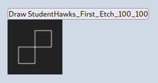

Learn to Program: Etch1 - Your First Program
Computer programming is generally done in at least 2 steps: writing the program and running the program. These 2 steps are repeated again and again as the program is developed. We'll use a previous program (above) as our first step. So here is our first written program:
Now to run that program, you'll have to put it into your own post inside the "etch1" tags as shown here:
      [etch1=My_First_Etch_100_100]UUU RRR DDD LLL LLL DDD RRR UUU[/etch1]
Go ahead and copy that line and paste it into a post of your own to check it out. You should change the name part from "My_First_Etch_100_100" to something else like "Bobs_First_Etch_100_100" or "Joes_First_Etch_100_100". You can name it anything you like as long as it is both unique on the page and ends with two numbers like "_100_100". Those last two numbers ("_100_100") are the width and height of the drawing area that will be created inside your post. You can use different numbers for different sized drawings.
OK, go ahead and give it a try. Just copy that text into your own post and change the name to your name (or to something creative).
Posts: 9003
Re: Learn to Program: Etch Series
Postby Student Hawk » Sun Feb 06, 2022 11:32 pm
OK, I copied that text into my post right here and changed the name to "StudentHawks_First_Etch_100_100":
When I click the button, my post shows this:
