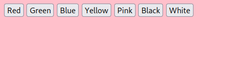

<!DOCTYPE html>
<html>
<body>
<script>
function setbg ( color ) {
document.getElementsByTagName('body')[0].bgColor = color;
</script>
<button onclick="setbg('red')"> Red </button>
<button onclick="setbg('green')"> Green </button>
<button onclick="setbg('blue')"> Blue </button>
<button onclick="setbg('yellow')"> Yellow </button>
<button onclick="setbg('pink')"> Pink </button>
<button onclick="setbg('black')"> Black </button>
<button onclick="setbg('white')"> White </button>
</body>
</html>
This version is now complete. It uses 7 buttons and one function. The final version (and all others are in the attached .zip file).

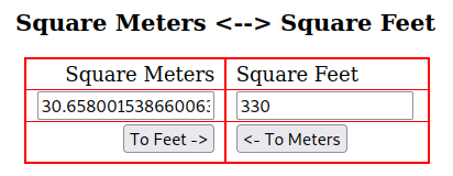

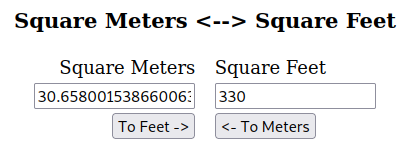

That program (HTML/Javascript web page) will give us the final product:
Screenshot at 2024-09-08 16-29-43.png (15.26 KiB) Viewed 24212 times
We can type a value into either the "Square Meters" column or the "Square Feet" column. The "To Feet" or "To Meters" buttons will convert a value from one field to the other.
