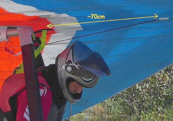

Postby Bob Kuczewski » Sun Aug 13, 2023 3:08 pm
I agree with Rick's post above. It is good to be prepared for such a situation if it ever happens.
But an ounce of prevention is worth a pound of cure.
With that thought In mind, here's an idea recently posted by "Plummet" (Don) on the Oz Forum. It consists of a simple elastic hook in reminder line that's attached to the keel a few feet forward of the pilot. The free end of the line has a loop that connects to the hang loop when hooked in which puts the elastic line under tension. This line is easily visible to the pilot and would be dangling in plain sight when not attached. I suppose the pilot could also reach up and tug on it to check that it was indeed looped around the hang strap.
Plummet posted a PDF file with the idea (attached below). This is probably the best picture from that PDF:
I really like the simplicity of this idea, and I might try it out on my upcoming flights.
