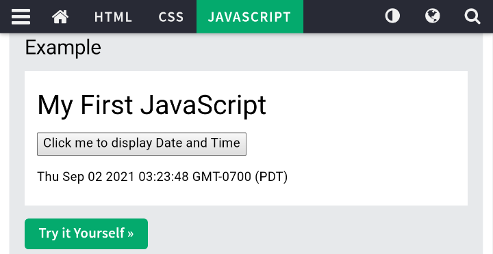

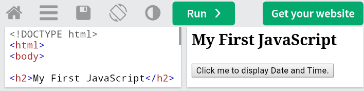

At each step in their lessons, they give you some instruction and then give you a chance to "Try it Yourself" as shown here:
When you click the "Try it Yourself" button. You'll go to a page that shows an editor on the left and the result on the right:
When you click the "Run" button, their web site will run your code (on the left) and show you the result (on the right). This gives you an easy way to try out any JavaScript that you like. You just have to remember to copy and save your text program when you are done ... otherwise it may be gone when you leave their page.

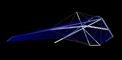

Now that Glider program is pretty complicated, and I wouldn't use it as an introductory example. But here's a much simpler program :

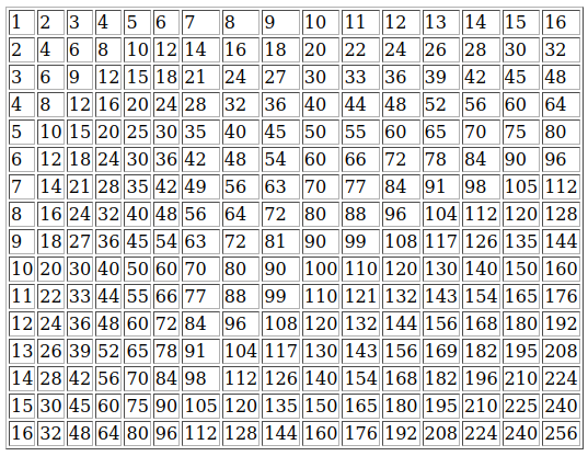

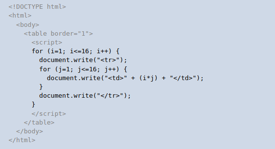

What does that program do? Well, you could copy that text, put it into a file named "mt.html" and open it with your web browser to find out (and I hope you will). Here's what you're likely to see:
Do you recognize it? It's the multiplication table of all numbers from 1 to 16. In other words, this little bit of JavaScript generated that entire table:
for (i=1; i<=16; i++) {
document.write("<tr>");
for (j=1; j<=16; j++) {
document.write("<td>" + (i*j) + "</td>");
document.write("</tr>");
That's the power of programming. Programmers learn to tell the computer what to do, and then the computer does all the work.

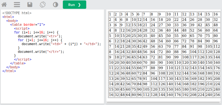

        https://www.w3schools.com/js/tryit.asp?filename=tryjs_default
It should look like this (after you've clicked the "  Run  " button):
As a final review, watch this animated slide for a few rounds until you are comfortable with each section. Don't worry about the JavaScript yet. We'll get to that later. Just be sure that you can make it run and get the table above either from a file on your computer or from the web interface at www.w3schools.com. Note that if you use the w3schools web site, you'll have to delete whatever program is already showing in the left side of that page before you can copy and paste this program into it and run it.

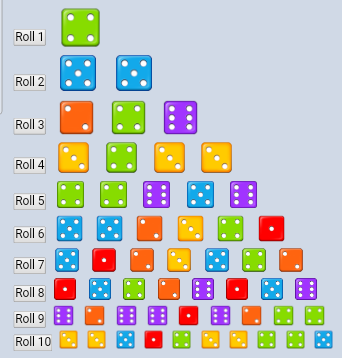

This is a fun variation of the previous program to roll some random virtual dice. This program isn't intended to be fully understood yet, but it demonstrates a more complete and potentially useful program.
Each button below will roll some number of virtual dice and show the results beside the button. You can push each button as many times as you like, and you'll get a different random roll of the dice for each one.

And here's a picture of one set of rolls (your dice may use a different font):

By the way, here's an example of rolling 400 dice at once. Just push the button to roll and re-roll all 400 at once. This is the power of computer programming.

Here's a complete HTML web page containing Javascript inside the "<script>" and "</script>" tags (the Javascript is red to make it easier to see). Don't worry about the details here, just note where the "script" tags separate the HTML and the Javascript:
<!DOCTYPE html>
<html>
<head>
<meta charset="utf-8">
<title>Roll the dice</title>
</head>
<body>
<h1>Roll the dice</h1>
<br/>
<script>
faces = [ "&#9856;", "&#9857;", "&#9858;", "&#9859;", "&#9860;", "&#9861;", "&#127922;" ];
function roll(id,n) {
if (n == 0) {
nt = document.getElementById("num_dice").value;
nv = Number(nt);
if (!isNaN(nv)) {
if (nv > 0) {
n = nv;
} else {
n = parseInt(n);
rs = "";
for (i=0; i<n; i++) {
d = 6 * Math.random(); // Six sides on each die
d=Math.floor(d);
rs = rs + " " + faces[d];
document.getElementById(id).innerHTML = rs;
</script>
<input id="num_dice" value="1" size="5"></input>
<button type="button" onclick="roll('dice_out', '0')">Roll</button>
<br/>
<span id="dice_out" style="font-size:60px;"></span>
</body>
</html>
Again, don't worry about the details in that file, just notice that there are two separate languages (HTML and Javascript). Here's another shorter example from an earlier post.
<!DOCTYPE html>
<html>
<body>
<table border="1">
<script>
</script>
</table>
</body>
</html>

<!DOCTYPE html>
<html>
<body>
<h2>My First JavaScript</h2>
onclick="document.getElementById('demo').innerHTML = Date()">
Click me to display Date and Time.</button>
<p id="demo"></p>
</body>
</html>
We haven't covered creation of buttons yet, but the highlighted section is attached to the "onclick" behavior of the button. In other words, when the button is clicked, the following line will be executed:
In other words, the program will get the element with the ID of "demo" and set its innerHTML to the current Date (and time). So the button lets us refresh the date and time without having to reload the entire page.
All of the programs from this post are included in the attached .zip file.
